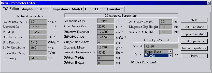

http://users.d-web.com/dbrown/db717tl/db717tl.htm
The RS180s models well in those cabinets, the RS150S might be OK.
perhaps MJK worksheet boffins would like to comment ?
Click the image to open in full size.
Unfortunately the RS180S crossover designs seeem to like overdoing it.
RS150S :
RS180S :
/sreten.

Unless you have a way to measure impedance, build the enclosure sealed. Knowing the impedance of your speaker is critical in getting the stuffing right in a TL.
Even sealed it will sound good, and give you a surprising amount of bass.
