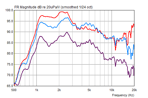

If you would like to compare oblade sheroide horn contour with LeCleach horn contour here, you would have to show us measurement *and* simulation setup for *both*.
I'm pretty sure there is a simple explanation in that simulation setup does not reflect measurement setup in favor or disfavor for one or the other contour.
In addition :
how does this bump in 12" OSWG + STX D800-Ti + 4.7uF look like in polar and impedance measurement ?
Like this (0/30/60 deg)
I suspect 4.7uF electrolytic capacitor resonate with driver impedance? Real+HP means I convoluted measurement with 1st order lowpass to simulate ideal 4.7uF cap. Anyway JMLC offers best midrange and you can't change that 🙂
Note: measurements taken with Bruel Kjaer 4149+2614 on 2610 measuring amplifier at distance 1 meter.

Given you seem to make this horns for Earls benefit – actually *he* should do the debugging – no?
Anyway - comparing impedance and SPL measurements you have shown, it seems, there is "real" problem involved with the contour you make – not just a fault in simu setup or the like
Here is what I got from a quick sim of the contour you posted – no 4.7uF EQing tho !
Without any baffle :
In infinite baffle :
Motor parameters and details of driver-horn-joint may not exactly fit your setup but what I see in this simus is more or less what you measure – the hump at ~2kHz clearly shows up.
Don't know why you couldn't catch it with AxiDriver ?
As for interpretation – IMO this specific mid band defect is *not* inherent to the oblade sheroide horn contour.
You can and should check out yourself what the impacts of a kink between origin (driver) and contour actually are.

I disagree Michael. The "kink" is cut and almost does not exist. Much longer kink is in compression drivers we use. Another thing is simu difference, what kind of motor parameters and solver you use, is it a secret? I use Horn-Flat Diaph.axi example and change only the baffle and diaphragm diameter.
Please apply HP or export Level dB in Axi and paste here.
One can check DE250 impedance with 4.7uF cap in LSPCAD to see those peaks. It is driver horn/dependent - seldom observed with Tractrix+dome tweeter.
*Almost* might be what you have to check out - at least if the contour data you gave is correct.
As said in one of the links provided - the OS is basically a diffraction horn - not that different from a axis-symmetric manta ray - just that the kink in the contour is shifted towards the throat.
This makes all the difference with respect to FR smoothness and other aspects IMO - but it also requires a driver that fits - not sure the screw on versions with their pretty long flare are the best choice here...
As for the LeCleach - this contour is the least affected by such drivers as it starts out with a very slow increase in angle - my contour is more sensible here and Earls is the most critical horn contour in this respect
I adjusted for best fit with measurements as the data provided here:
D-800-Ti - STX Polski producent - kino domowe g?o?niki akcesoria
did not give any good match
Your 4.7uF cap EQing is degrading FR tracking between measurements and sim some further in this case - as the corresponding peaks in electric impedance get "inverse amplified"
