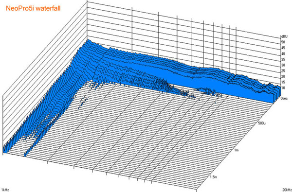

As I said, the woofer probably should be very fast, up to the tweeter.
I don't know much, but looking at Zaph's measurement of the W18EX001 it looks very good, considering the low crossover point for the NeoPro5i:
Click the image to open in full size.
Zaph also states that this woofer would enjoy a very low XO point - 1600Hz, which seems quite up to the tweeter!
He doesn't like ribbons, but it seems that my experience and so-called design goals might be worth a shot with the combination.
He recommends LR 4th order.
The recommended XO type for the NeoPro5i is 2nd order. Why is that? What would happen if crossed at 4th order?
(reminder: I'm thinking of active XO)
However, the W18EX001 is not a high sensitivity driver and that's too bad. Can high sensitivity drivers deliver equal or better timing? Zaph tested some Fostex drivers, but found the non linear distortion figures not optimal. However, considering that the speakers will not be used at high level, maybe meens improvement in that area?
Here it's clear why the recommended XO frequency is 1500Hz.
Thi measurement is different then Zaphs, can anybody evaluate the timing difference between the 2 drivers in say, 1500 or 1600Hz?
