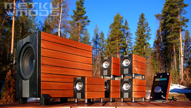

Click the image to open in full size.
How do you like this mod...?
http://www.metku.net/index.html?path...wood/index_eng

I may steal the fake leather idea myself. I thought it would look terrible but ......
I would have preferred a more solid veneering without the stripes but it's a minor gripe. I just think it would look less 'mass market'
That's really got me thinking.
And Tangband drivers too!!
Excellent link Nordic
