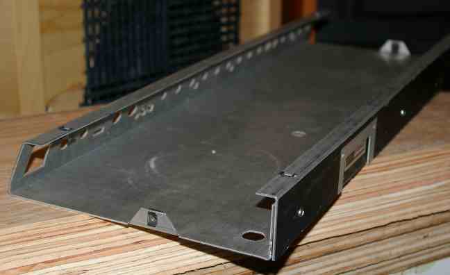

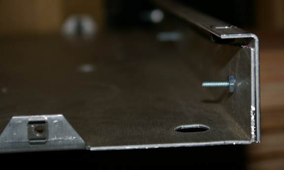

Okay, starting to get down to business:
I have stripped the original Fender Transistor Twin chassis,
and spent a week toying with the idea of taking it to a school shop,
and using their bender to fix it up.
Then I just spent ten minutes with a 2x4 and my body weight,
bending it myself on the floor. Not bad.
Now the chassis platform is horizontal,
and the front piece bent at an appropriate angle.
I have yet to saw the over-tall back piece off and re-bolt it,
so that the top-screw lugs line up with the holes in the cabinet.

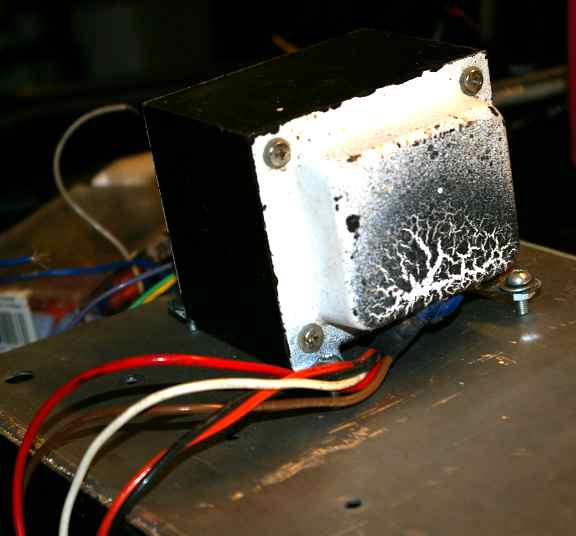

On the left (chassis) is the Boldec 100 watt Ultralinear transformer.
The bells were painted white and fired for coolness (wasted now inside Fender cab).
On the right (chassis) is the HV tranny and the giant (10 H?) choke (bigger than tranny!).

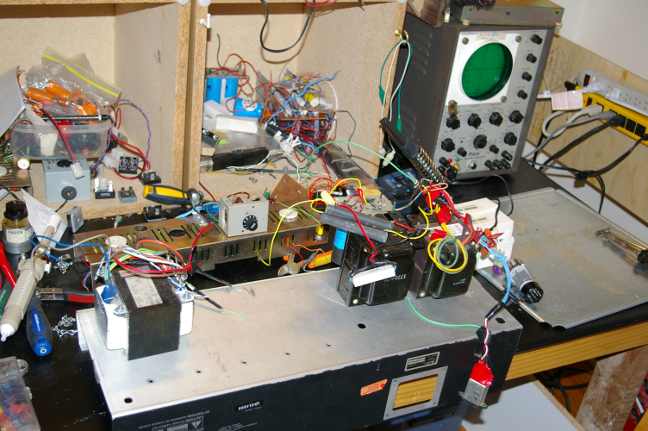

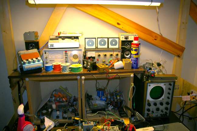

I built a bench for him under his bed-loft, (see pic),
to encourage him to learn some electronics before his dad goes senile.
He inherits a lot of cool bits, like that classic EICO oscilloscope,
and custom test-jigs for tube circuits (see upper left).
Some might recognize the ancient Heathkit tone-generator at top right,
and the quickly obsceletized "Distortion Meter" beside it (heh heh).

The chassis needed one more modification.
The extra long back was sawed off, leaving about an inch;
The extra piece was also sawed short, to match the height;
This piece has the bend and chassis-bolt nuts which take the back bolts from above.
The piece is bolted to the rest of the chassis, to give a strong,
level surface for mounting the transformers and tubes.
As a result, new holes will have to be drilled in sides of the wooden Fender cab, to line up with the side-bolts.

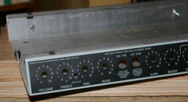

Good news is, most of the front panel can be re-used, the old way,
with chassis-mounted knobs and point-to-point, using a turret board.

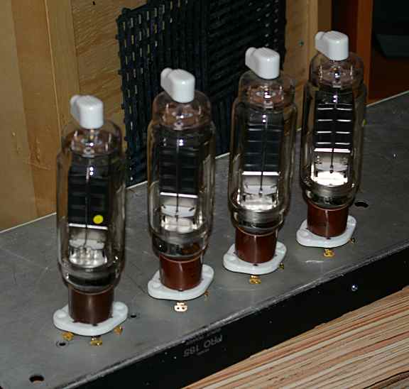

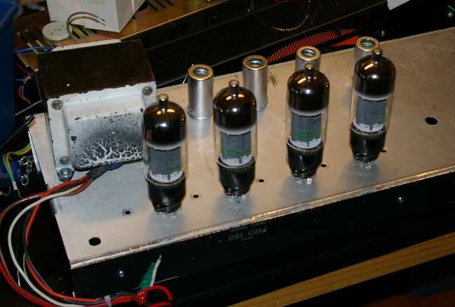

Here's a closeup of the Boltec 100watt UL transformer, with painted bells.
The 'burnt look' was created with a crackle-paint, sprayed lightly over the white.
It gives a hint of the mayhem to come from this best guitar-amp ever built (tribute).
Still pining to use the 814s, but it will have to be on another even more dangerous amp... alas...

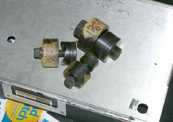

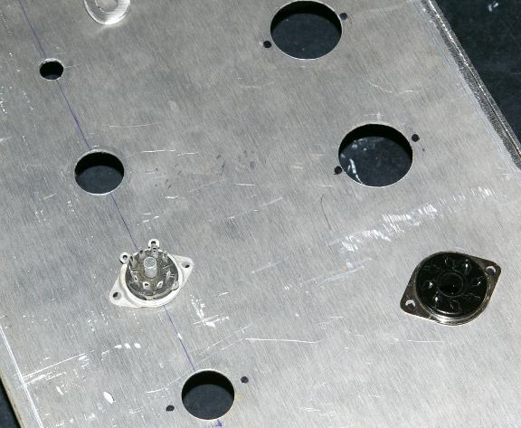

Starting to prep the Chassis!
Here's the latest pics of the build:

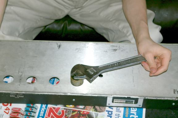

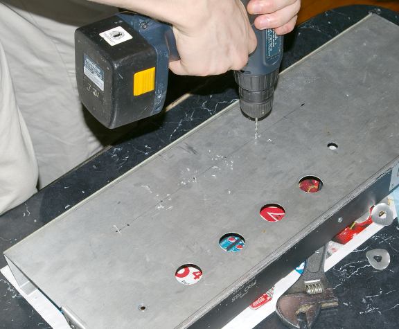

These hole-punches are a lifesaver.
They pay for themselves with their first use.
Make sure you use cutting-oil and regular oil on the threads, to keep them sharp.
For accurate hole-placement, small pilot-holes are drilled, then a 3/8" hole for the bolt of the hole-punch.
A half-dozen turns and the piece snaps out, leaving a perfect, finished hole.
Even if this project is a flop, nothing beats watching the son actually perform useful work!
- and he's gained experience with a new tool, the hole-punch.

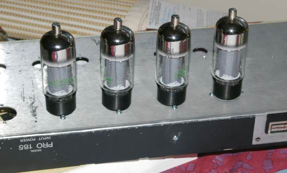

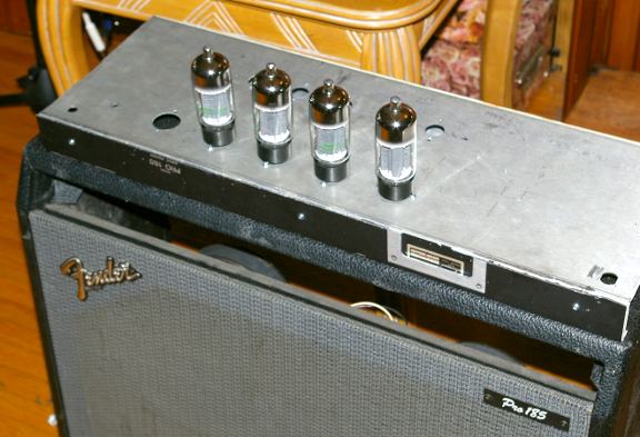

Holes for the mounting bolts are also marked and drilled.
Really nothing should be mounted until the transformers are drilled and bolted on,
but its hard to resist the fun of pre-assembly and a first look:

Nice, looks great so far. Lots of small holes there. This thread has been dominated by output stage talk, but what's your plan for a pre-amp? Looks pretty substantial! 🙂
Also, do you use any kind of layout software to figure out placement before starting on the chassis? One thing I learned from my first build was that efficient parts placement can be challenging. I rewired my PS three times and the pre-amp twice before I was satisfied, and I'm still not 100% happy with placement in a few sections.
Well, the basic idea will I hope be to use the front panel almost as it is,
with two basic channels.
In this case, I'm going to try to have one Marshall (overdrive) and one Fender channel (clean).
Each channel will have its own style tone-control, and the Marshall will probably have a distortion/gain plus some switch-in presence or some such.
There will also be a 'Soldano' channel, but it may be switched in/out or subbed for the Fender. Still toying with the problem of 3 channels in a 2-channel frontplate.
Sonically I think we can have everything we want in one amp.
But layout and footswitches might be a compromise.
Nope, I'm not using any layout software or PCB routing aids.
I hope to wire everything point-to-point using some standard turret-boards for the guts, and in part rely on mini-PCBs for the tone-controls/channels.
There isn't that much to a guitar amp,
but the challenge will be educational for my son the assistant.
I don't want him to miss out on the frustration of doing awkward layout.
This is an experience-building project, so he'll have to heatsink or swim.

Here my son is drilling the holes for the massive choke (larger than the Power Tranny!). We had to check for clearance with the speakers in the Fender cab.
After this quick training exercise, my son is now a professional Grommeter!
It first seems impossible to stuff correct-size grommets into the hole, And in the past I've even cut them to assist in tucking them in. But the best tool for this is simply a medium flat-head screwdriver. You have to watch it, so that the rubber isn't penetrated or torn, since that defeats the whole (hole) purpose of protecting the wires from contact with sharp metal edges, and also providing electrical insulation.
