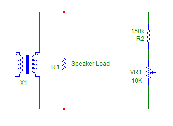

In my past build (5w powered preamp) I installed my master volume pot across the OT secondary and ground, with the wiper feeding the output. There is an 8ohm 5w resistor across the pot/output. (8 ohm because of the OT secondary impedance and because a speaker may or may not be hooked up).
What would be the safe practice for accomplishing this trick with a higher wattage amp (speaker permanently connected), say 40w?
Put a resistor in series with the pot (signal - resistor - pot - ground) with the wiper still as the output.
A 40 watt amp will have a signal of about 18Vrms at full tilt, so a 150k in series with a 10k pot will give a little over 1Vrms max on the pot as a starting point.

Here is what I meant
  Reply With Quote
Old 22nd February 2012, 08:36 AM   #10
diyAudio Member
Join Date: Feb 2012
for some reason the pic didn't appear. try this
Click the image to open in full size.
