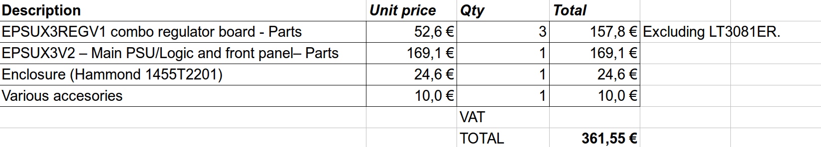

It is time now to start to know if DIYers and how many, would be interested to built this project.
In fact, i've already made much work on doing the project to be easy to do as possible
(but i don't recommend this for newbies as first building project).
I've also work a lot these days to make a precise cost evaluation, because of course
price is always a major parameter to build something or not.
You will find below, a summarized cost tables to build the full project, including beautiful
Lexans panels and professional 4 layers PCBs.

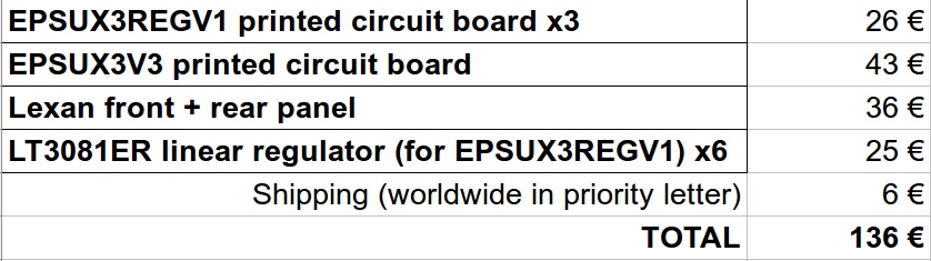

First, the group-buy parts list;
And here, the components you need to buy separately :
The total project cost is about 136+161 ~ 500 €.
This price for the group-buy "kit" is reachable for a number of builder of 25 at least.
Of course, if we reach 50 or 100 (we can dream ! 🙂) the price will decrease much.

In the group buy i will offer only :
EPSUX3REGV1 combo regulator bare printed circuit board. ( 3 of this)
EPSUX3V2 main bare printed circuit board (1 panel with main board and front panel board)
Front and Rear panels Lexans
LT3081ER linear regulator. (6 of this)
All these parts are light and can be shipped from me to anywhere at low cost.
All others parts must buy by yourself.
Of course, if US DIYers want to organize a components group buy to get
better prices on a single ordering, i encourage it.
In my group buy, i've add the LT3081ER regulator, because the design need six
and that represent a high price. For a group buy of 25, we need 150 regulators
allowing about 2.5 less expensive.
It's also small, and i can easily dispatch them worldwide with PCBs and Lexans
in same small letters.
