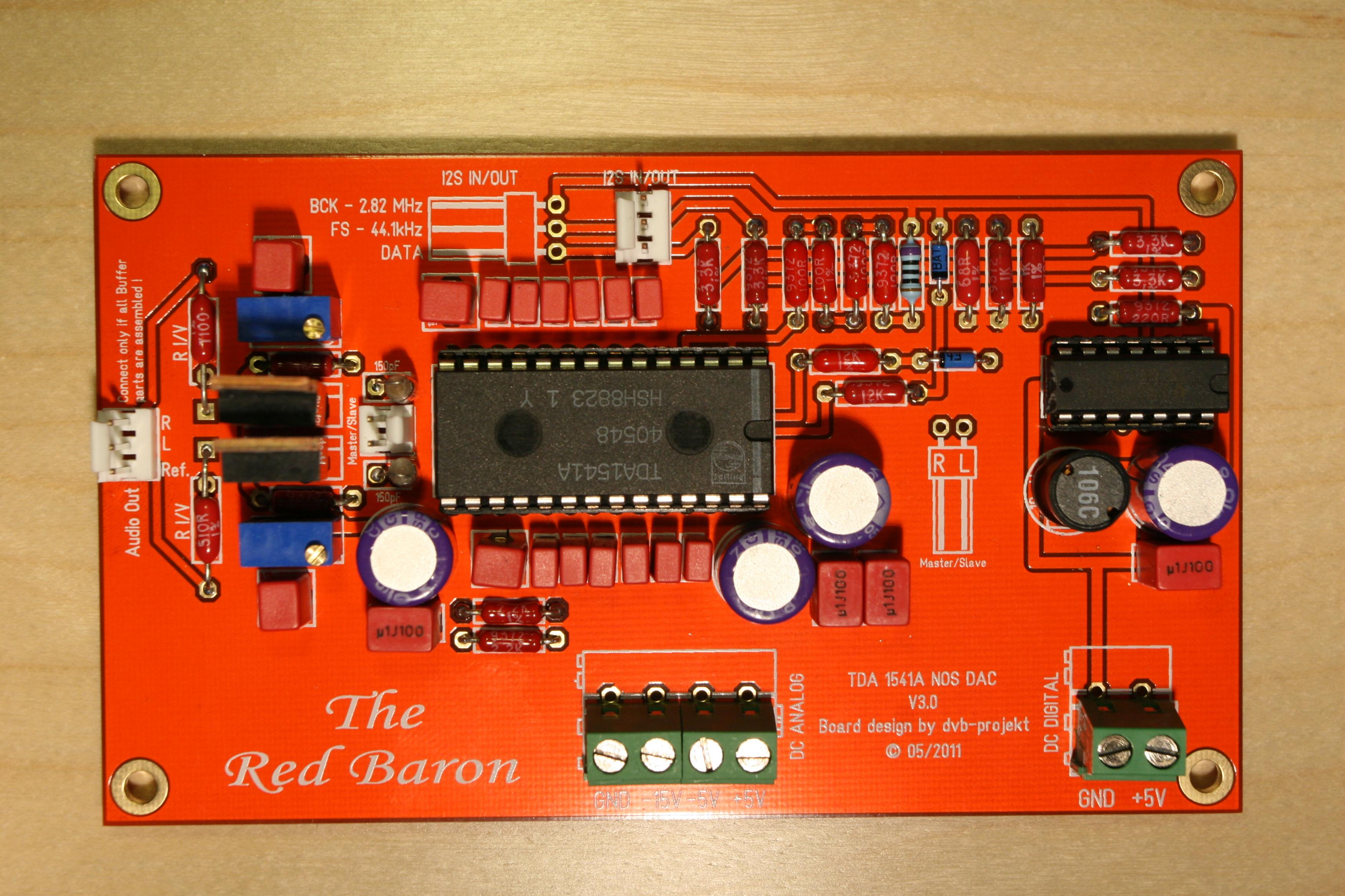

Hi All,
On the Red Baron PCB, is there any downside to substituting the Nichicon FPCAP R7 150µf/16V for 220uf/16v caps?
Next try to get red baron to fly
as a follow up to my post http://www.diyaudio.com/forums/grou...dac-i2s-bus-architecture-151.html#post4718234
I finally managed to get some time to try to get red baron to fly again by re-configuring it to run in I2S mode and connecting it directly to the I2S outputs of Ian's clock board.
It does not work and I suspect that the reason for it is that there is something wrong with 1N4148 diods.
There is a nice signal going in to diods from WS/LE and DATA/L u.fl sockets:
and on the other side of the diods the signals (without changing the scope settings) look like this:
Can anyone provide a scope view on the diod outputs, or the WS DATA/L TDA inputs for comparison?
Any hints on what could cause this signal change apart from obvious - broken diods?

Thanks a lot for the great explanation of digital interface flaw and the roadmap to get the attenuator circuit to work!

Hi Ya gents,
sort of a newbee question here!.Sorry to bother but i am sorta stuck😕.
On my CDPro 2 I can locate the 12 s output connector- a 6pin effort- so i made a colour coded lead to fit-- with the mechanism on the floor and as i look at it square on from left to right , according to the Phillips data sheet :
Pin 1= Misc (N/c on my lead)
Pin 2 = SCLK (Black on my lead)
Pin 3= WCLK (Brown on my lead)
Pin4= DATA (Red on my lead)
Pin5= Gnd ( Orange on my lead)
Pin6= graphics o/p (N/c on my lead)
Now looking at the Red Baron DAC input: 12S Ground is self explanatory
DATA is also self expansionary
However Sclock (from the CD Pro2) is that BCK or FS on the Red Baron I/P?
Also FS, (from the CD Pro2) is that BCK or FS on the Red Baron I/P?
Any help accepted, as i have yet to hear music from the Red Baron (but i know its in there somewhere!)

Hi Johnny,
Not a bad question at all.
I pulled this from the Wikipedia article on the I2S standard:
The bus consists of at least three lines:
1. Bit clock line
2. Word clock line - also called word select (WS) or left right clock (LRCLK)
3. At least one multiplexed data line
So it sounds like on your board the SCLK should be connected to BCK on the Red Baron. Though I just looked on my twisted pear receiver board and it has both an SCK and a BCK output and I use the BCK. Not sure why?
Here is a Phillips paper on the I2S specification:
https://www.sparkfun.com/datasheets/BreakoutBoards/I2SBUS.pdf
I hope this has been of some help 😱

Hi all,
Came back with a question, now, that I've (finally) finished Red Baron, I want to feed my headphone amp with it.
What I've did:
I've set 0V vs. Digital GND via potentiometers.
I've wired the reference module to Red baron as in picture.
I've set the 0V to RCA outs via potentiometers on the reference module board.
What I want is to feed a headphone amp via 3.5mm jack.
In this case the both ground will be linked together.
Will that be a problem? I've found around 1.5V between both RCA out grounds...
Kind rgs,
Alex.
What I've did:
Kind rgs,
Alex.
It should not be a problem.Anyone please correct me if I am wromg here.
If you check the schematics. All the signal grounds are usually commected together.
So it will happen regardless of the connectivity type you are using rca or headphone jack.
Kind rgs,
Alex.
Hi Alex,
in this post http://www.diyaudio.com/forums/grou...dac-i2s-bus-architecture-152.html#post4765880 dvb-project says to connect the gnd of the dc reference module to digital gnd. Not sure why, but hope this helps.
Having some issues setting up the Red Baron.... I have -0.8V on both L and R channels to GND, playing with the pots does almost nothing. Any ideas? I don't know what the hell I'm doing.
Imgur: The most awesome images on the Internet
You made a failure with the I/V Resistors.
Please solder the 2nd end of the resistor to the quadrangle solder point like here on an older RB V3.0!
The round solder point vis-á-vis is for the form factor of i.e. TX2575 naked bulk foil resistor.
Best,
Oliver
Hi Oliver!
And for me, does the schematic looks OK? 😀 I didn't shunted the I/V res. when soldered.
Still can't figure what would I do with two different voltage GND from DC ref. board common in the 3.5mm jack for headphone amp.
When I common I get different readings for DC voltage vs. when I measure each channel with it's own GND.
Kind rgs,
Alex.
