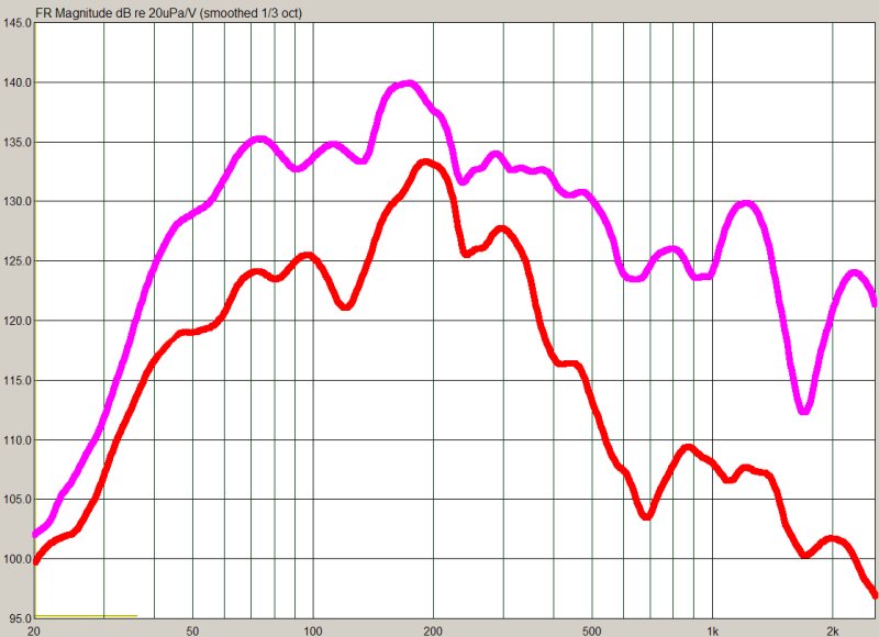

subwoofer pictures?
The small sub is a tapped horn with three MCM 55-2421 woofers. About $35 a pop.
The big sub is a clone of a TH-Mini with a P-Audio SN-12MB. About $140.
The rectangular sub is a clone of an Autotuba, with an MCM 55-2421. I moved the mouth of the horn to couple with the pass-through from trunk to cabin in my Accord.
If you're good with wood working, three of the small subs could be a nice match for Summas. They're fairly flat to 500hz, and excursion shouldn't be much of a problem in a tapped horn. Admittedly, there is little output below 40hz - they're all for my car, where cabin gain gives us free output below 80hz.
Here's some measurements I did this morning. The purple line is the tapped horn, the red line is the horn. Check out my posts on diymobileaudio and diyaudio for instructions on how to make them yourself.
