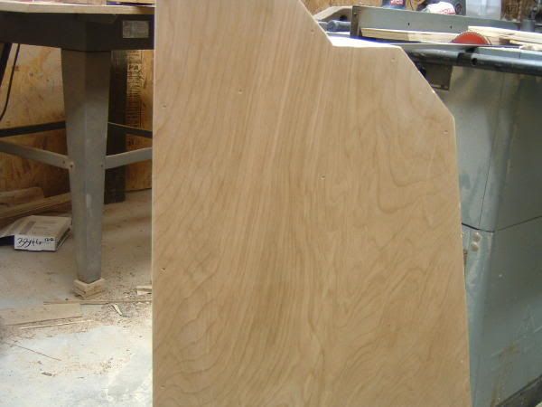

Well I started cutting my wood today. I cut my peice of ply in half so I had two 4' squares so I could have the grain run up and down the speaker as opposed to across, but its going good.
I am just making two packets, one for each speaker and hope to have them assembled within a few days. Some pics to come tommorow.
I am going with the provided CC size, i assume that it will be ok. And if not then I can always change something, or just live with it. I think that I might put alittle poly fill in there to up it.
I assume that poly fill works with full range projects...

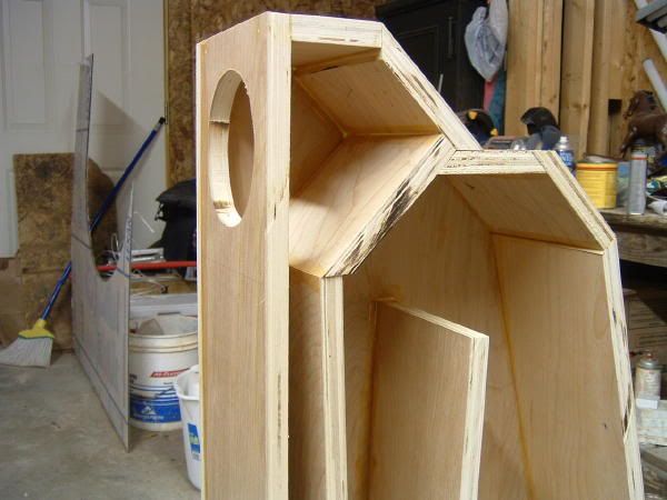

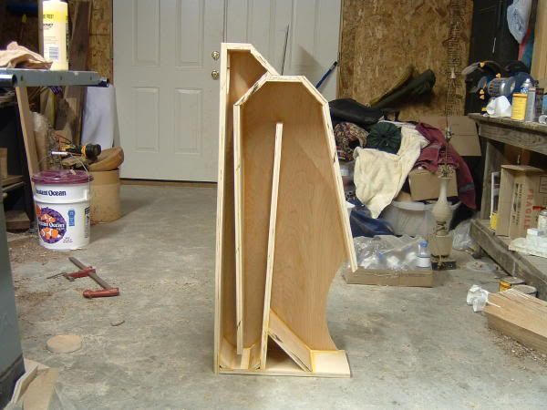

Since Im going to veneere *sp the face and the top, basicaly like a strip on the front and around, with rose wood I used a finish nailer alittle... but its all togeather, that one is

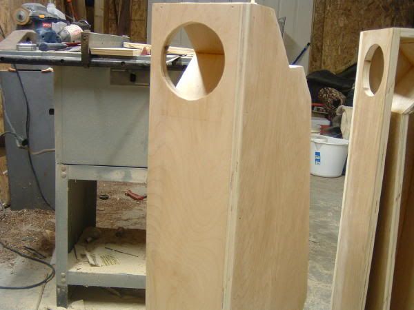

Well Im almost there. Drivers and terminals will be here on monday. So onec I get those Im going to clamp a peice of ply on the side and see how they sound.
I am looking into what i can do to make the sound better, tweeking wise. Any suggestions are welcome.

I hope you used the 2.2 liter CC?
After extensive reprogramming and simulations i found that was the minimum volume for a roll in of unrestricted(un loaded) cone movement at around 230 hz. This was established for un loaded frequencies in the bottom of the vocal range.

I used the chamber that was listed in the PDF above.
I would hope that is the right size since the speakers are now done.

I took and using a bag of water I measured the CC and its deff the 2.2 one. It filled a liter bottle over twice once pored out of the bag.

Very good!
You will have a response from the A126 that sounds like a much larger speaker and have excellent cone control.
I would suggest a supra baffle and one of Daves modded Fe126 drivers.

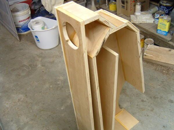

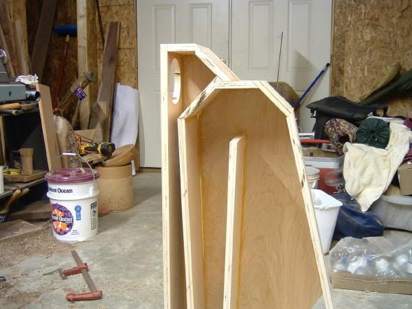

For the rear deflector what is the angle? and is it just the hight of the rear horn part.

Never built them, in fact i have never heard them. They are all designed around physics and math with no application of "voodoo". (save your river rocks for the slingshot)
Slightly greater (4") than the height of the mouth and for full wave development a 45 degree slope up. The incident angle to the reflector ,when wall loaded, will be 45 degree.

Ok Im having a hard time if you mean it is going to just be a 45 degree wedge that is 4" taller than the mouth, or if it is going to have another angle once it gets twords the top.
