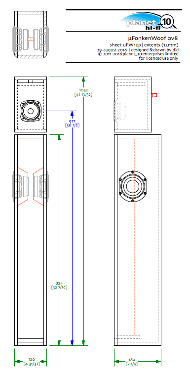

This is a version of one we have done that works very well and acts as stand for the uFonken. We are also working on a number of designs for the Silver Flute W14.
