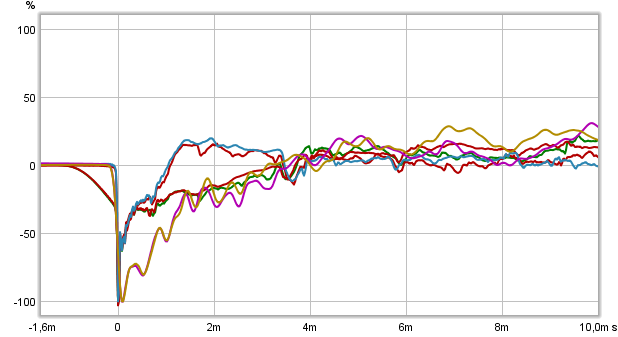

So here come the measurements! These are all taken 60cm away, on-axis, 88cm from the floor (mic height exactly between the two drivers which incidentally is also the listening height). The full-range one is taken with 350Hz Harsch XO (4th order BW on woofer, Bessel with 1,6ms delay on fullrange).
What I can immidiately see is no phase shift on crossover frequency! I uploaded all measurements to my dropbox, and would appreciate if someone with a bit more experience with REW could take a peek. One of the things I'm wondering is the 800Hz bump on the speakers. From what I've simulated with Edge, it seems this is probably caused by the baffle step. Still, didn't expect it to be that steep.
https://www.dropbox.com/s/5ggxg0hssvuuo38/measurements.zip?dl=0

That dip at 800 Hz is there in the early signals. Looking at your IR you can see the first bigger disruption at ~3.45 ms, so your gating could be set just before that and be pretty much clear of reflections. The dip is already there at this point though, and could come from edge diffraction. But it could also be something else (the back chamber).
Do you have means to make an impulse reading of your 10F in the enclosure? REW can do that with a few wiring tricks and a known resistor. That would tell us if it's from within the box or something else from the outside.

I deliberately show the waterfall to see what it does for the early signal. This waterfall is limited to 3ms, it shows the dip is already there before the first obvious reflection takes place.
Sorry to set the EQ back to Generic, it's easier for me to predict it's outcome and I only wanted to see if we could clear up that dip. The very high Q PEQ settings won't work if the dip is changing shape off axis. We need to see on axis and every 5 degree step out to ~25 degree to see what is happening. It could also change if the mic is moved further back. Any dip that changes once we move further away (with the mic) we won't be able to "EQ" out either.
