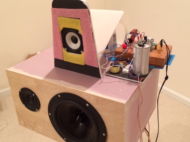

This is a subjective blind test, 6th in series of tests of full range drivers, but with this one concentrating on whether or not eNable treatments to a FF85WK driver are audible. In a related thread, I showed that the differences were measurable as small 1dB variations in the 1kHz to 10kHz range. I then developed a passive FAST speaker to allow the testing with a state of the art class AB MOSFET amp (VHEX+) with an external DAC (UCA202) driving the amp, a passive crossover design, and a transient perfect FAST speaker utilizing an RS225-8 woofer in a sealed cabinet. The driver under test (DUT) is mounted in a Dagger style short aperiodic (vented) TL with a trapezoidal baffle for a clear, open sound signature with minimal box coloration or diffraction effects from a rectangular baffle.

Here is a photo of the test setup:
