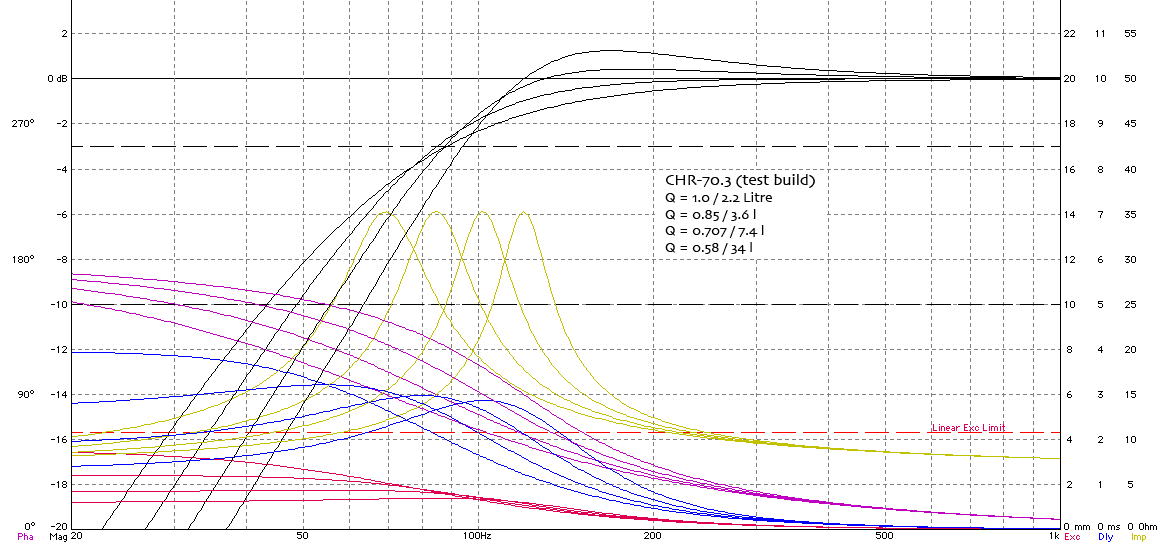

If you have a 150 Hz fixed XO i would suggest a sealed box.

Sealed box is also an option, thanks for the input. Come to think of it, ported / vented designs usually enhance the low end performance and in this specific application, that won't be needed. So striving for a more linear output is actually a good idea. Which design would you recommend, then, Dave? This looks solid to me: mMarS-1v0. It is about 5.6 liters of volume. I am gonna try some simple simulations as well.

Looking at the sims, you'd likely want to target Q=0.707. About 7 litres with no damping, 5.5-6.5 litre with damping would suit.
