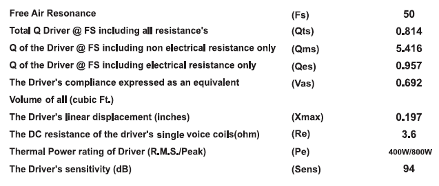

I just ran across this subwoofer from the car audio world. Look at its specs and tell me if this just isn't perfect to make a simple 0.5 cu ft sealed box to hit 56Hz easy with lots of SPL to be the bass unit in a FAST system. With 94dB sensitivity, you can afford to give up even a full -6dB to baffle step loss and be at 88dB to match with several nice high end 3.5in to 4in full range drivers for the tops. ScanSpeak 10F, many Fostex's, B80, etc. For $41 seems like a total bargain. Anyhow just putting this out there in case anyone is interested in trying it out as it is dead simple 14 liter sealed box and run a XO at circa 300Hz to 500Hz.

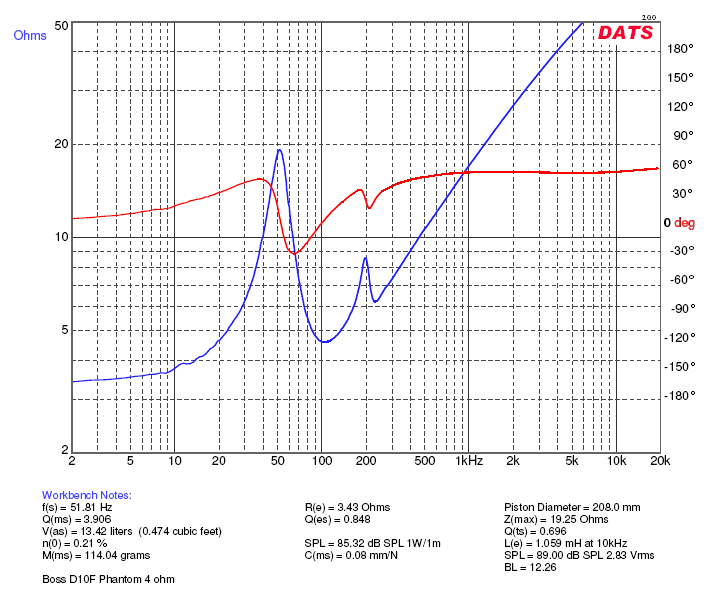

The Boss arrived
I got the driver today, looking at and holding it in my hands it feels well constructed. Nice alloy frame, very shallow profile, nice nickel plated spring terminals, the suspension is very stiff for a woofer, a huge half-roll surround that appears to be molded out of a slightly softer material than the cone but the cone and surround are integral and one continuous piece.
Some photos - looks just like advertised:
Put it up to DATS and many of the TS paramters like Qts, and Vas are better than the factory spec, but the sensitivity is coming in at only 89dB at 2.83v, a far cry from the advertised 94dB. That may in itself be a deal breaker as it was the raison d'etre for this driver.
There is also a very large rising impedance above 100Hz and funny business going on at 200Hz with an impedance peak there.

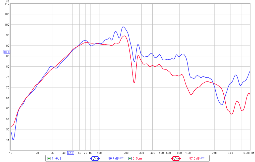

1 cu ft box meas
This is a 1 cu ft cardboard box with foam inside to get an idea of the bass extension and also the higher frequency midrange extension.
The measured sensitivity is consistent with DATS prediction of about 89dB, maybe 90dB at 2.83v and 1m. Here is 2.83v minus 6dB at 0.5m for equivalent sensitivity. Also a 5cm nearfield measurement (moved to line up) to show native response without room modes and reflections.
The driver appears to have a 47Hz f3 if we assume that the baseline sensitivity of 90dB.
The sharp dip at 250Hz really limits this driver as a sub woofer and not a woofer. Really not suitable for FAST unless you cross below 200Hz. Although the dip at 250Hz may not be that audible as sharp dips are hard to hear. You may be able to get away with crossing it up higher. The bass as a sub does go pretty deep for only a 1 cu ft box.

At 87dB, typical; 5dB baffle step loss if not wall mounted so, 82dB in practical sense. A Vifa TC9FD is 85dB so would need padding or a BSC to match. But the upper end falls off abruptly at 200hz so not the best for a FAST. Really, it is a subwoofer below 120Hz would be best. I do like the fact that you can get 50Hz reach with a relatively compact box, albeit, with overshoot. A 1cu ft box may be better. I am stuck with it as I never got around to requesting a return soon enough. It does make a nice power load for testing high power amps. I am working on some 100w and 200w amps now and have no qualms unleashing full power on this thing as it's built like a brick bunker. The cone feels like a stiff poly lid to a 5 gallon can and the surround is a stiff (barely flexible) plastic that is the same as the cone material. I don't think it's possible to damage this below the 400w continuous rating. Getting a 400w power resistor might actually cost about as much or more and doesn't have the excitement of flapping a big woofer when testing an amp for the first time.
