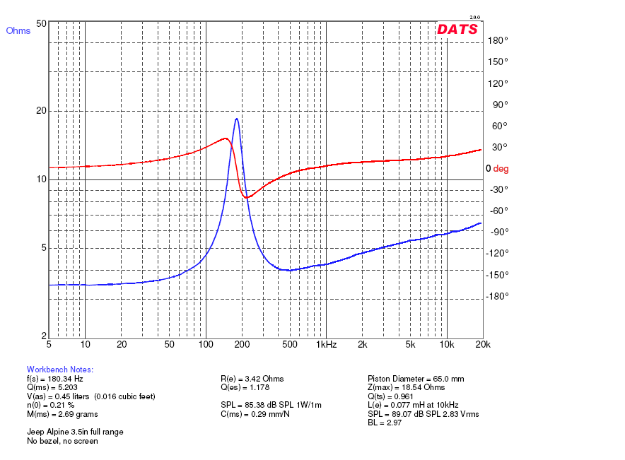

A member asked if TS parameters exist for this driver. I have not seen any published. Here are the TS Parameters for Jeep Alpine as measured with DATS V2 using added mass method on driver with bezel and dust screen removed:
fs=180Hz
SPL=89.07 dB at 2.83v
Re=3.42 ohms
Le=0.0773 mH at 10kHz
Mms=2.865g
Qms=5.203
Qes=1.178
Qts=0.9606
Bl=2.97
Vas=0.45 liters
