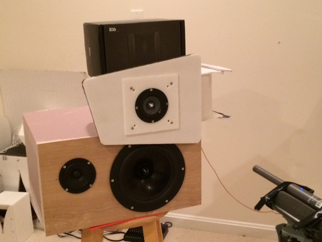

The hardware setup is a little different this time with a sealed 24 liter cabinet loaded with a Dayton RS225-8 woofer running with a Linkwitz transform, and I will be using the new S. Harsch crossover topology (http://www.diyaudio.com/forums/multi-way/88135-filler-driver-ala-b-o-26.html#post4399135) that provides near transient perfect response with a steep 4th order Butterworth low pass on the woofer and a 2nd order Bessel high pass on the mid/tweet. The electrical frequency is 350Hz, but resulting acoustic crossover is near 500Hz. A FAST implementation is use once again, to offload the bass duties from the drivers so that their midrange and upper range can be compared in an apples-to-apples fashion. Some of these drivers will have superior bass capability vs others in a properly designed cabinet (the A7.3 for example has extension down to 40Hz in a MLTL). However, that would require different cabinets for different drivers and then we cannot isolate the effect of the listening test to just the driver vs the driver and cabinet combination. The amp will be a Ybdz TPA3116D2 modified with Panasonic OSCON 330uF SEPF caps and the 330pF/10R bootstrap snubber mod on the mid/tweet. Amps are driven with standard laptop 19v 4.65amp smps bricks. The DSP crossover is a 2x4 miniDSP running advanced 2-way XO as usual. Source is a Phillips 5 disc carousel CD player using the headphone outs to drive the miniDSP inputs. Music is taken from original CD's and trimmed to 45 second clips and placed on one long track so that all song clips are recorded in one continuous stream without touching recorder setup. This really improved the workflow and made taking data much faster, and more consistent between songs.
The measurement mic is now a miniDSP UMIK-1 calibrated by a third party (Cross Specrtrum Labs). The measurement mic and Zoom H4 digital recorder share the same stand and are swapped in and out. The clips are recorded as 96kHz 24bit raw .wav files and then trimmed and level adjusted in Audacity for a max -1.0dB FS output. Audacity is also used to convert the .wav files to 320kbit mp3 (48kHz sample rate). The setup is fixed with the only thing variable is the driver under test and its adapter baffle plate to mount it to the Nautaloss infinite baffle like sealed rear spiral TL. The center-to-center distance between the driver under test and the woofer is 7.75in. The mechanical and physical locations of the mic stand, speaker cabinets, etc are all identical between cases. The ONLY thing that changes is the driver between tests, and the ONLY adjustment electrically is the level matching gain on the mid/tweet (up to -5dB depending on driver sensitivity) and a very small 20 to 80 microsecond delay adjustment to compensate for driver offset due to bezel thickness differences.

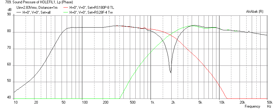

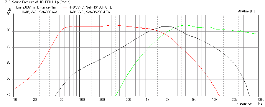

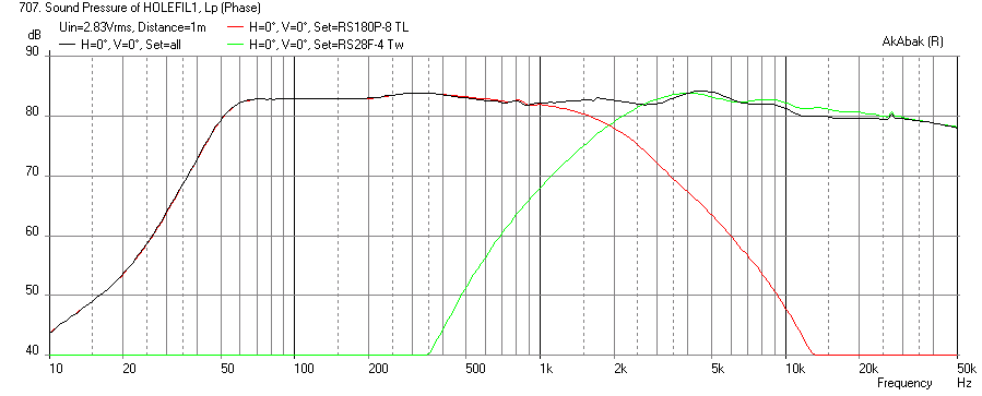

Here is an example of the XO frequency response taken from the 10F/8424 and RS225-8 Ref Monitor but using the same Harsch XO topology with a XO frequency of 400Hz:

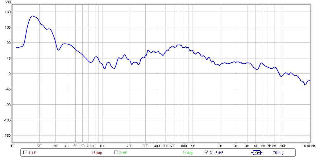

This is the absolute phase of the system (fairly flat for a 4th order BW and 2nd order Bessel at 400Hz - no phase wraps):

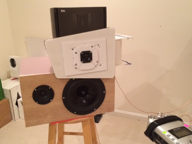

Here is a photo of the test setup with a driver being measured for frequency response (mic at 0.5 m distance, shorter distance used to avoid floor bounce cancellation and to minimize room reflections). Note that the ScanSpeak 10F/8424 visible in the same cabinet as the woofer is not connected or used. (More info about the woofer cabinet can be found in the 10F/RS225 Ref Monitor thread):

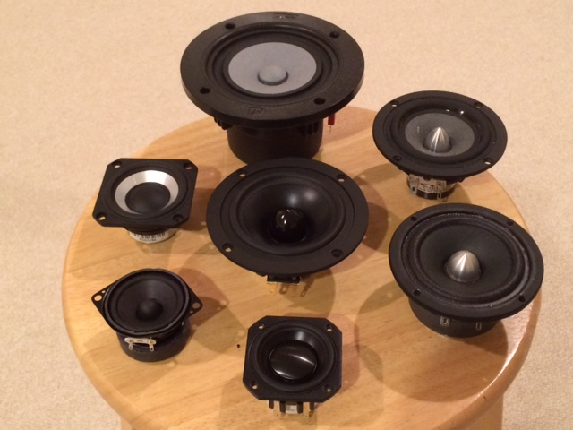

Here is a photo of the line-up for Round 3. From the top and going clockwise A7P, W3-1364SA, LGK, P830983, FRS5X, SB65WBAC25-4, B80 (center),and A7.3 not shown:
