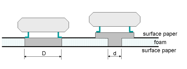

Several suggestions:
1. Bigger is better 😀
2. Rounded corners (or irregular shapes) can help diffusing edge reflections. Think water tank - ripple experiment. Your added masses act like some stones along the banks, also diffuse the wave effectively. As you can see the effects vary a lot.
3. Foamcore board is light, so it's easily damped. Constrained layer damping can be applied locally around edges. I've try felt pads and they work well. See Manger's bending wave unit.
4. Foam is soft and can eat some vibration energy from the exciter. On such material, driving the front surface of the panel helps a lot in HF. Refer to the following sketch:
Cut a shallow hole and retain the front surface paper. Fill the hole with some other dense material - solid cardboard, plywood etc. So the exciter is now driving the front surface more directly, instead of riding on the spongy rear surface.
One step further, the dimension where exciter drive the board affects the highest frequency. My little exciter has 1" VC. The driving ring is about the same size. It can play up to 20kHz on proper panel.
If the rigid 'transmission' can be built in a smaller size, theoretically the HF can be even higher. Like the one on the right.
5. For the low end, in addition to bigger panel area, you'd need higher driving force. A powerful exciter, or multiple smaller ones.
6. Heavy 'panel' like framed glass can work. (or, every surface can) The main problem is the resonances could be too strong and hard to control.
I've also tried this. The glass is fix on a dry wall. So the exciter on glass is actually driving the glass and the whole wall. There's a huge peak at 32Hz, and other irregularities in frequency response here and there. Very amusing effect, but impossible to deal with those problem physically. Severe EQ is needed.

All these were driven by a stereo amp, with the central one on one channel, and other 4 on the other. Inputs of both channels see the same signal.
That's the way I wired them, and it was very good right at the beginning. So I didn't make any change.
Sticking pin(s) through different layers should be a great idea. I haven't tried such technique myself, but would expect great results. I think this would work very well on corrugated cardboard, too.
One thing I can't explain is the bipole character, polarity, and the impulse response.
If it is indeed bipole, the polarity on both sides should be the same. So, it should be no different driven by normal or inverse polarity. But how can we explain the impulse response? -- Very high positive peak and very low negative.
