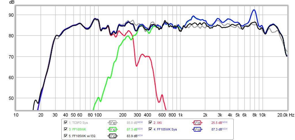

My experience with the FF105WK, although limited to a FAST setup, is valid for the upper registers where I have a problem. It has a very prominent peak at 7.5kHz, which some may find adds "life" to certain vocals. There is also an exaggerated high plateau from 1.5kHz to 4kHz that sounds very forward. Without EQ, my ears could not take more than 5 minutes before fatigue sets in. Additionally, the 7.5kHz peak causes ringing which makes transients less sharp. However, once I EQ'd out that peak and high shelf - all sounds very nice and balanced. Quite an enjoyable driver now with good sensitivity (some of which was lost in EQ). Here is response before and after EQ (blue is raw FF105WK, black is after EQ, grey is TC9FD):
The setup is same as for "Subjective blind comparisons..." thread.

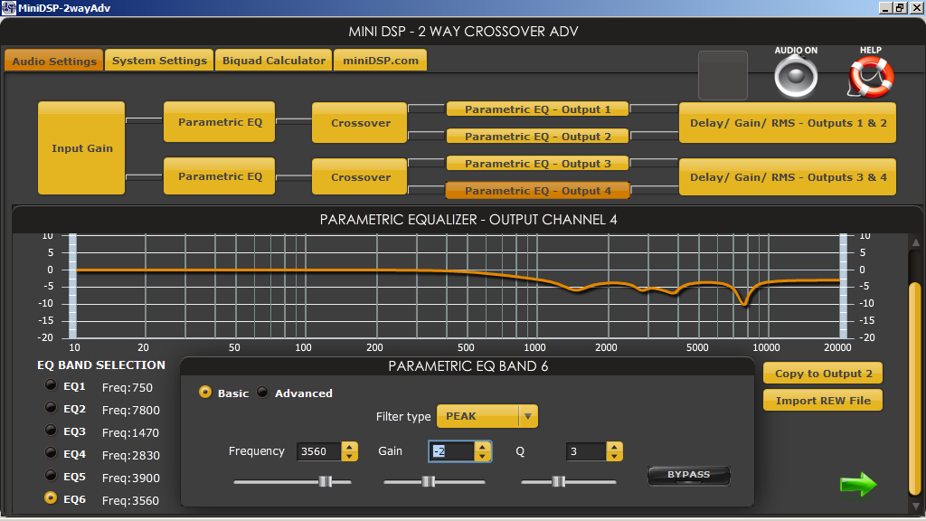

xrk971: how did you use EQ? Was it a setting on your amp? A crossover network? I'm a complete noob and there's a lot I don't know yet.
It was done using a miniDSP which provided both the XO and EQ for a FAST implementation as described here:
http://www.diyaudio.com/forums/full-range/270094-objective-comparison-3in-4in-class-full-range-drivers.html
The specific EQ for the FF105WK was implemented using 6 different parametric EQ's as shown here (basically an approximation of the inverse of the response above "flat" from 500Hz to 8kHz):
