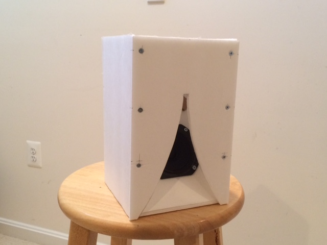

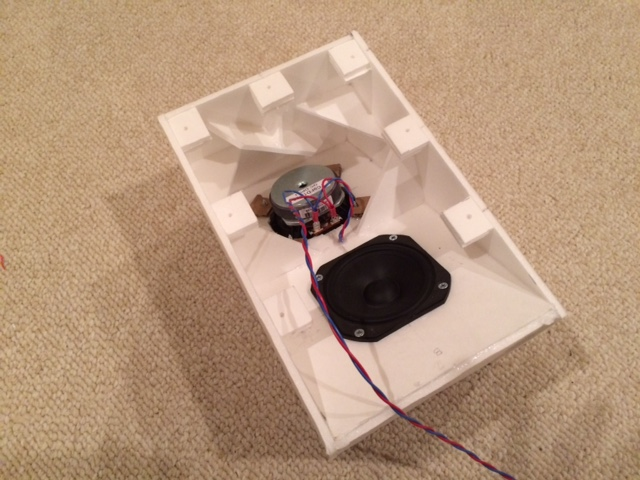

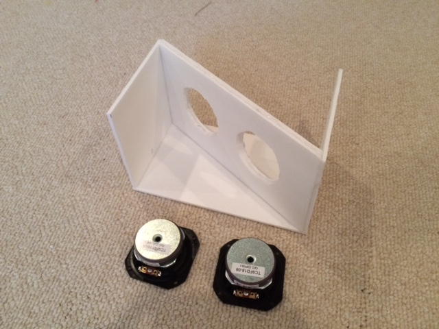

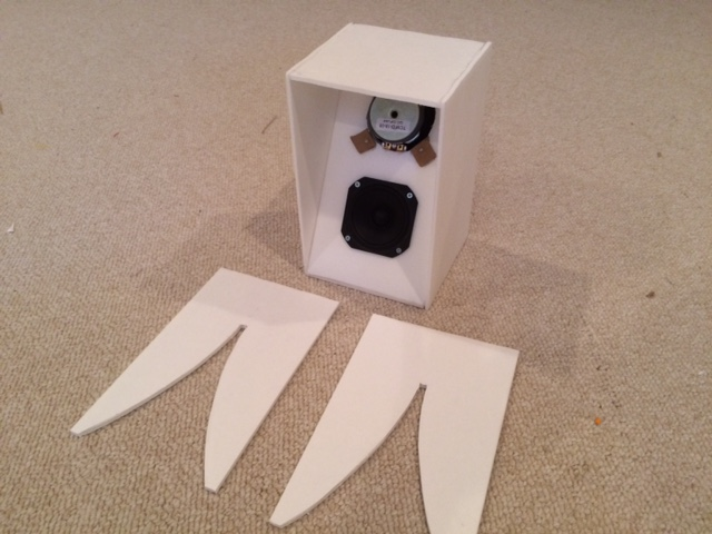

Before making a big one for the dual 8 inchers, I am building a small prototype in FC for the TC9FD, called the mini KaZba. This will not have any bass as it is scaled way small, but will give me some practice in the construction and also to model it in Akabak so that I can optimize the chamber volumes and Karlson aperture cross sectional areas for optimum performance.
470258d1425783066-rockin-kazba-dipole-k-aperture-z-baffle-dipole-mini-kazba-photo-1.png
470259d1425783066-rockin-kazba-dipole-k-aperture-z-baffle-dipole-mini-kazba-photo-2.png
470260d1425783066-rockin-kazba-dipole-k-aperture-z-baffle-dipole-mini-kazba-photo-3.png
There is a lot of air pressure - need to double up layers as it is rattling now...

Added bracing and some stuffing
I added lots of little 90deg corner angles to brace the walls and reduce rattling and vibrations. I also doubled up the K-aperture with two sheets of FC glued together. This worked pretty well, and then added some fiberglass stuffing behind the magnets of the drivers to help absorb some chamber reflections.

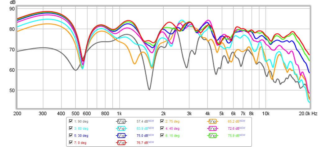

How does the dipole work? In a dipole box this small, there is not enough of a baffle distance to get any bass - there is some but it starts falling off below 200Hz. The K-aperture combined with the chamber reflections and some of the bracing is creating a lot of dips in the response. I took some polar data and the box seems to be doing its thing, frequency dips, notwithstanding. What is there, is following what I expected for the polar response from a K: uniform over 5dB up to 45 deg off axis up to about 10kHz. The dipole effect can be seen with a fairly uniform 20dB attenuation at 90deg off axis. The data shown is at 0.5m with a gate of 1ms before and 4ms after for a resolution of 200Hz and stuff above 400Hz is good.
470277d1425798133-rockin-kazba-dipole-k-aperture-z-baffle-dipole-kazba-tcc9fd-polar.png
Here is the impulse response from the 0 deg case:
Here is the harmonic distortion from the 0 deg case:
This quick FC study is giving me some good lessons learned for the real build with the 8in drivers. I tried listening to this speaker, and it sounds surprisingly good with the some female vocals and jazz despite the several deep notches in the response. What is good is the uniformity of the sound as I walk around the room, or behind it. Just directly to the side, the response is very low as expected.
