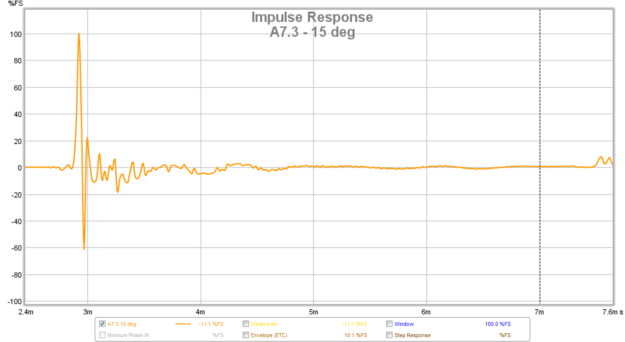

Yes, from post #47 (http://www.diyaudio.com/forums/full-range/267966-why-bother-frs-5.html#post4184730), I said
In plot below 15 deg is the orange curve:at 15 deg, it starts to noticeably appear cleaner with less hash/ringing after the initial pulse. It may be the sweet spot for listening with the A7.3
Here is corresponding IR:
Whereas if you listen at 0 deg, the IR looks like it might have come from ringing bell:

Even if the response looks smoother at 15 degrees the variations within the listening window increase with off-axis listening. The larger the full-range driver the larger the variations. The smallest amount of variations is generally found around 0 degree.
A lot of problems can go unnoticed when looking at the off-axis response in 15 degree steps. 5 degrees steps or smaller within the listening window is more revealing.
pnix said:Even if the response looks smoother at 15 degrees the variations within the listening window increase with off-axis listening.
So your conclusion is, "listen on axis, no matter how bad FR is" ?
My conclusion is to listen on axis if the response can be equalized. If it can't be equalized then the driver is beyond repair anyway.
tc9 looks pretty flat till 8-9khz about 15 degrees off axis.
