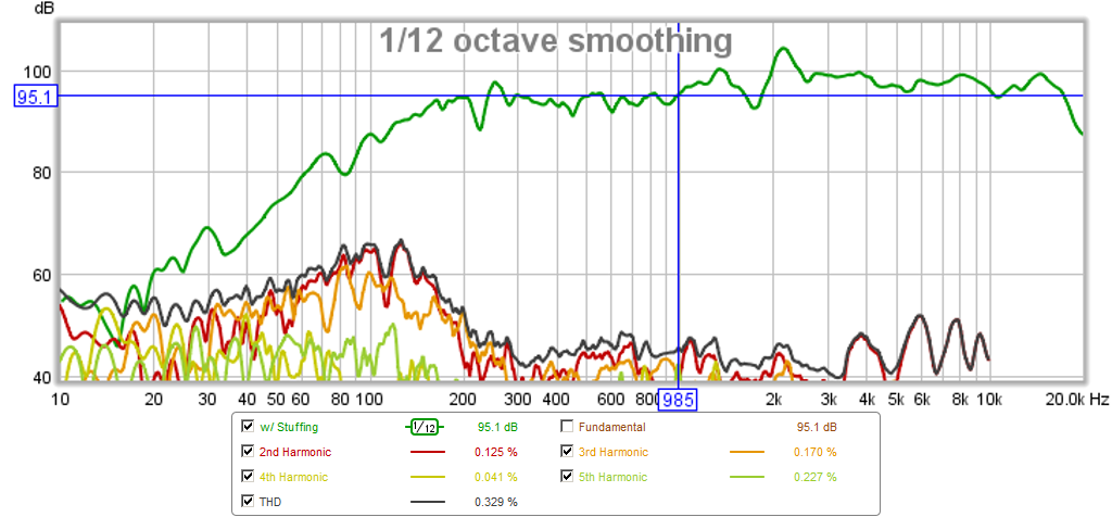

The HD on axis from the front where the direct radiator is actually quite low - less than 1% above 300Hz. The re-radiated emission from the back at 180deg is higher in HD, but that doesn't reach the front given the measured data above.

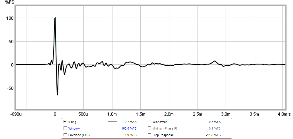

Note that the impulse response from the front on-axis is excellent and has virtually none of the ringing that is apparent from the 180deg data. This is almost an ideal impulse response, and you can imagine has a very good looking step response.

I've attached (crude) screenshots of measurements taken from my listening spot (a distance of 5') showing impulse response and frequency response of the hypercubes with and without the small amount of correction I use while listening. Also attached is a photo to tell a little bit about the room since it's definitely a factor in these measurements.
