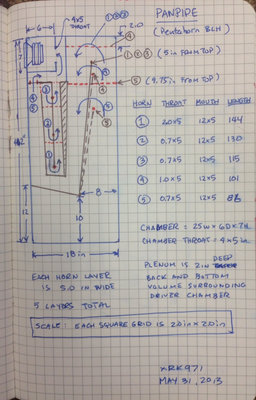

See the Panpipe thread or Cornu thread. Not a bad idea at all.
The PANPIPE (Pentahorn) BLH Speaker

model it in MJK and see what comes out... the 3 stubbs, i think, will all act as one, and with "the pipe" open at both ends will be a half-wave design.

Right, they will average out to some tuning [Fb] between the two extremes, but not necessarily to what the middle pipe is tuned to.

If you have a sufficiently small throat each pipe or horn will still have a 1/4 wave mode - at least that is what the sims in AkAbak show.
hi X, I just checked your thread, I think it's really awesome!
Any real impedance measurements so far do you know?
I hoped this idea works(and better yet, can be predicted by simulations). If they do, it will encourage the use of smaller drivers, which I liked a lot.

Location: Virginia
Quote:
Nothing built yet. Someone was starting to draw plans up based on my design but it all sort of petered out. I can get predicted impedances if you are interested in that.
