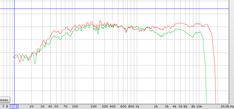

This is my sweep done with both arrays in my concrete rectangle of a listening room.
The green is without EQ, the red with an early attempt at EQ. Things moved on since, but it gives an idea.
I boosted some high end, and the dip, centered at 1k is intentional, I find it clears the music and singers have a less nasal tone.
