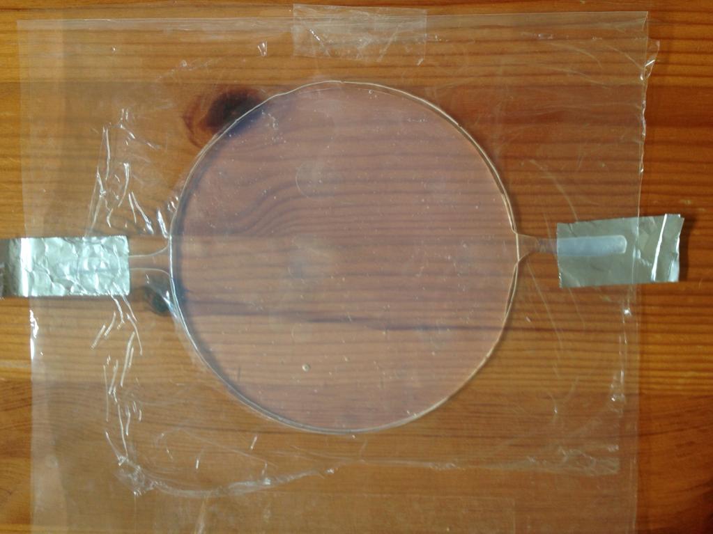

Agar gel speaker attempt
I had to try this speaker, so I made one out of agar gelatin (I think seaweed based) and salt. I made a circular gel dam out of a rolled up string of silly putty and then poured the hot gel into the dam. Once hardened, I placed two of them in a sandwich with plastic food wrap in between. I covered both sides with a firmer sheet plastic to keep the gel from drying out and used aluminum foil as electrode strips.
So how does it sound? It doesn't quite work yet. I will need to add more salt and use a step up transformer I think. When I connect it to a 45 watt amp, nothing, but when I connect 120vac power mains to it I hear a slight 60 Hz hum. So it does move but not very efficient. Probably how thin the insulation is, and amount of salt loading are critical. However, the mechanics and substance/substrate for making it is all there.

Perhaps the membrane needs to be porous similar to the insulating sheets used in lithium ion polymer batteries.
Good idea, I will give that a try. A Gore Tex membrane may be perfect for this. What is a cheaper more readily available substitute? I could just put a bunch of pinpricks on the plastic food wrap - that will act more like distributed point sources rather than an area.
Also you have the negative and positive terminals effectively at the same point. this would cause the electron flow to travel the shortest distance between the two. One of the other pics showed a wide ring with one conductor on the inside and the other on the outside. Doing it this way would help force a much more even charge between the two gel 'plates'.
Not sure why you say this?
The gel discs have a conductive "tail" that leads from the main disc. Each one forms the terminal to the electrical input which leads out each side diametrically-opposed and on separate sides of the insulating plastic film.
This is exactly the same electrode layout used by the researchers.
The gel is a conductor - why would charge be greater at the perimeter? It's not like metal where electrons flow only on surface. It is an ionic volume conductor - like a flat tank of salt water - there is no charge locality.

Update: a serious limitation of the agar gel speaker is that it is what is used for culture medium for bacteria and fungi. So without any anti-microbial agents - it becomes a mold science project - yuk. Had to throw it away 😀
