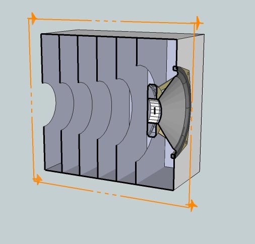

If you want to go smaller, you may want to try a "Boffle" (a highly vented box designed to simulate an infinite size box).
http://www.diyaudio.com/forums/full-range/236729-silencer-speaker-baffle.html#post3507792
The blue line is a 3 liter box and the red line is a 9 liter box. You don't gain much low frequency extension by going with a larger box.

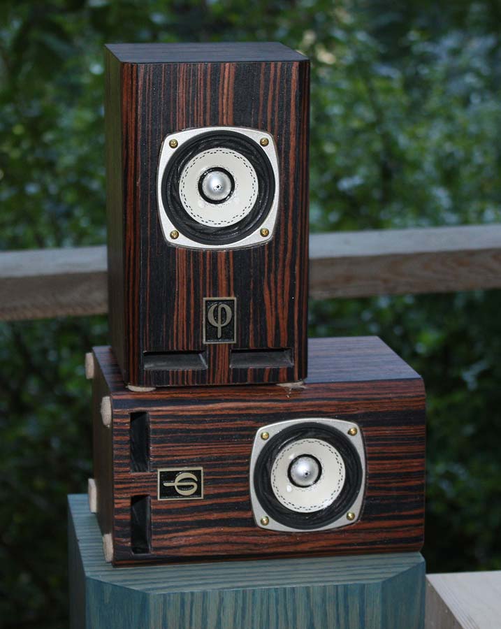

Fostex FF85wk is my goto for a small speaker. In the uFonkenWK (nominal 2 L) they just reach 100 Hz
(here with the older FF85k)
dave
dave
