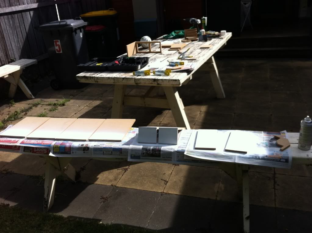

Todays work!
Stuff getting a little bit of matt white

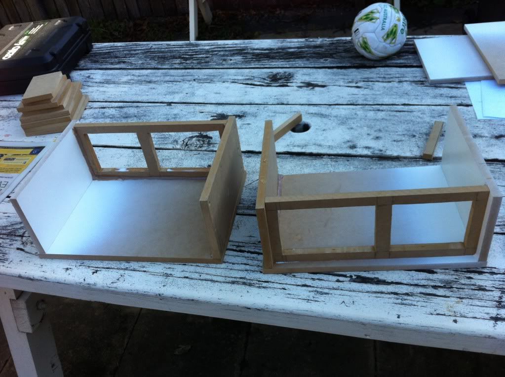

Cabinets getting assembled

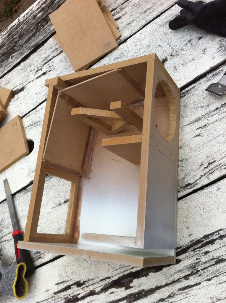

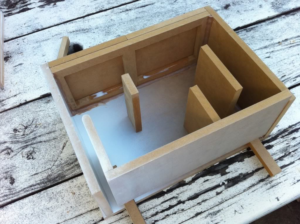

I had some fiberglass reenforced filler sitting in the garage un opened, so Used some of it, Bad choice for building speakers, The fiberglass is a killer, The paint was also blocking up the 240gritt sandpaper I was using. Need to grab some more paper and give these a good sanding and primer filler paint for a good finish.

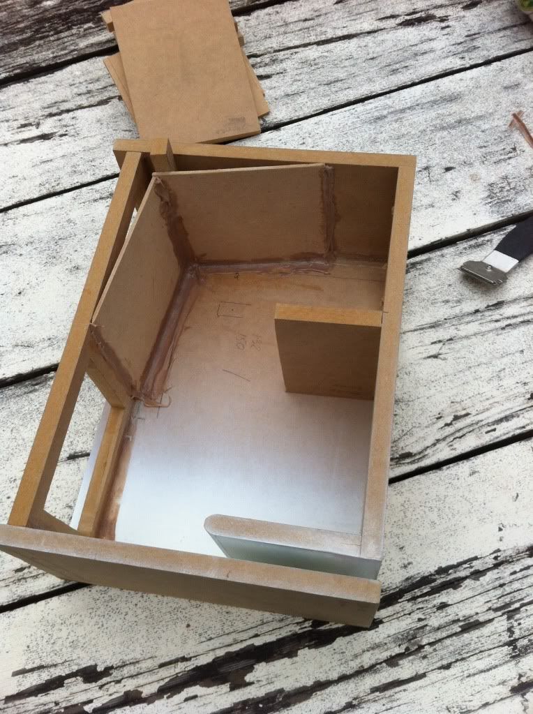

Roughly how the guts will look, the front face is held up just for the pic due to the wet liquid nails on the joints.

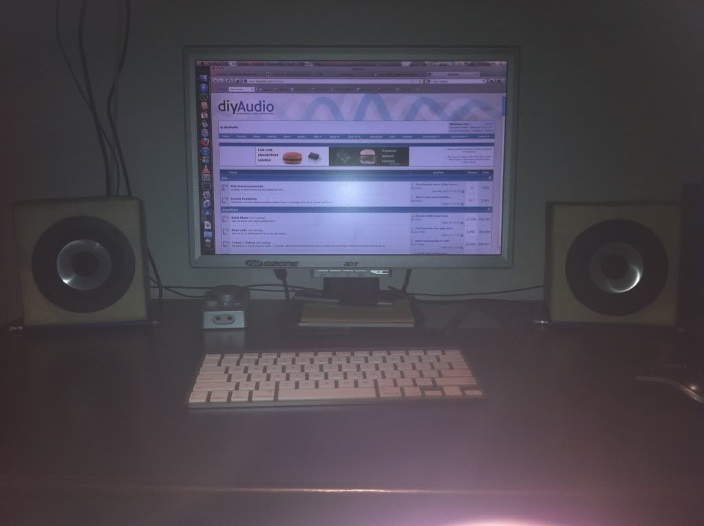

Drivers have arrived 😀
Still waiting on router parts which have been posted, stocked up on sandpaper, Only time has been lacking this week, Should get some done on the weekend.
Obviously me being me, I just didnt want the drivers sitting in the box, Meet the $10 burn in box.
Cardboard 15cm cube, double wall, ex box from a furniture product.
2 rolls of $2 masking tape
Some off cuts foam door seal gasket
$3 rca lead (to plug into the sub of my logitec M4's)
$3 cheap *** poly filled pillow haha
I got a glue gun for $4 but it was crap haha
3 hours one night.
Filled them with the cheap pillow stuffing, Dont sound half bad connected to a cheap 2.1 system, Will do me for burning them in, The high pass on them is wayyyy to high, no mid bass at all, But I cant adjust it.

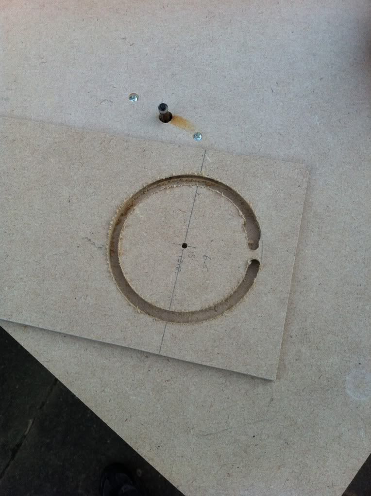

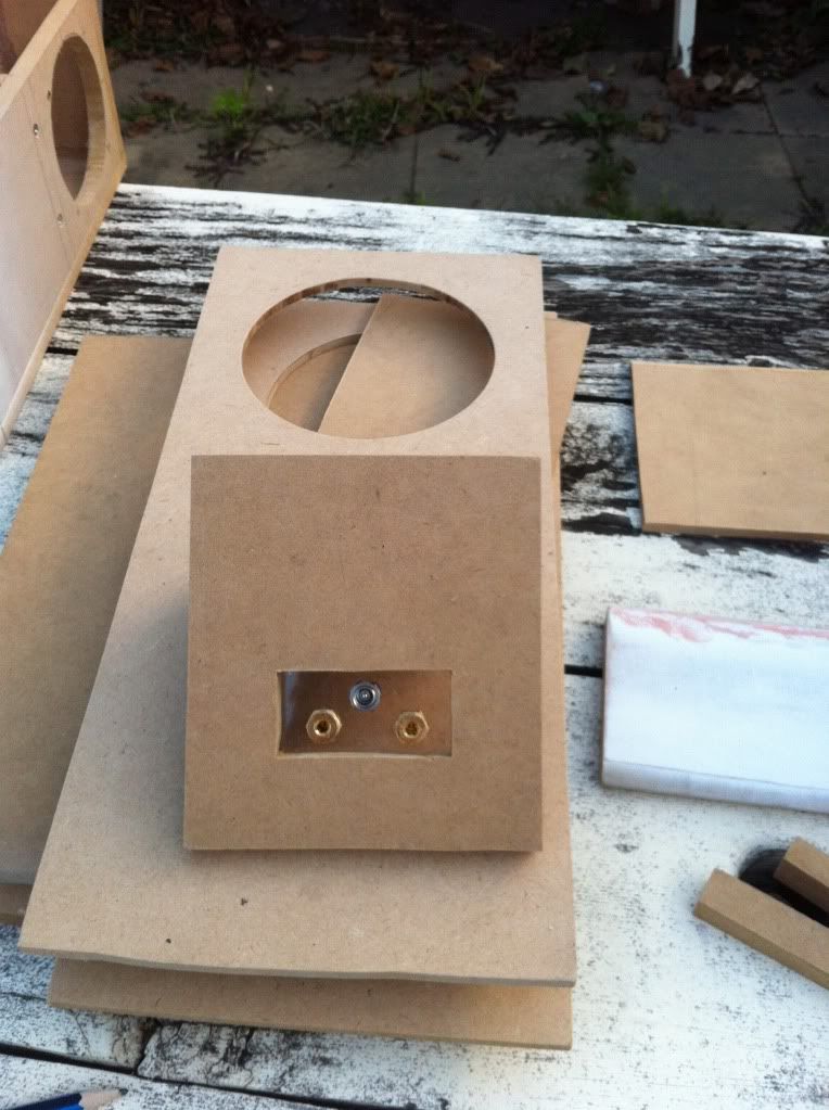

So cutting the front face out for a flush driver. Made 2 of them, they were a little big for the driver, so made another hole on the jig and it was perfect! 😀 But ran out of 6mm MDF to make a 2nd perfect one, Will get some more next week and do that again.
And one of the box's so far.

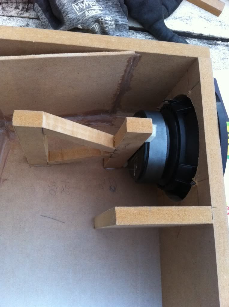

You can see the woofer brace I did in this one, I didnt go for the conventional holey brace, I just made a braced brace lol Its solid, and will be screwed into the box at 4 points.
It also looks like a circuit diagram label for a speaker as well haha
The other box it a little more behind, I had cut out the hole for the driver in the front face I has attached the port baffle to and was using a 45deg chamfer bit on the router to chamfer the inside of it. And well went too deep and the edges of the circle made the front face way to week, and the bearing dropped below the timber and it got all messed up.
So I will need to make another face for that box, not bothering chamfering them now, it makes the front face too weak in this particular box. I was able to save the port baffle so its all ready to be remade, just need to get to dads where the drop saw and left over timber is.

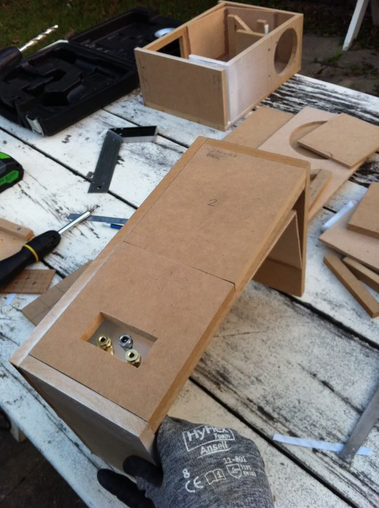

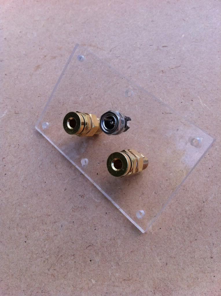

I couldn't find any half decent terminal plates that suited my needs, So DIY time, Had the perspex sitting around.
Sitting on the removable rear piece
Back parts sitting in the box.
The rear bits will be painted matt black after a little primer. The rest of the box is going to be veneered in bamboo
