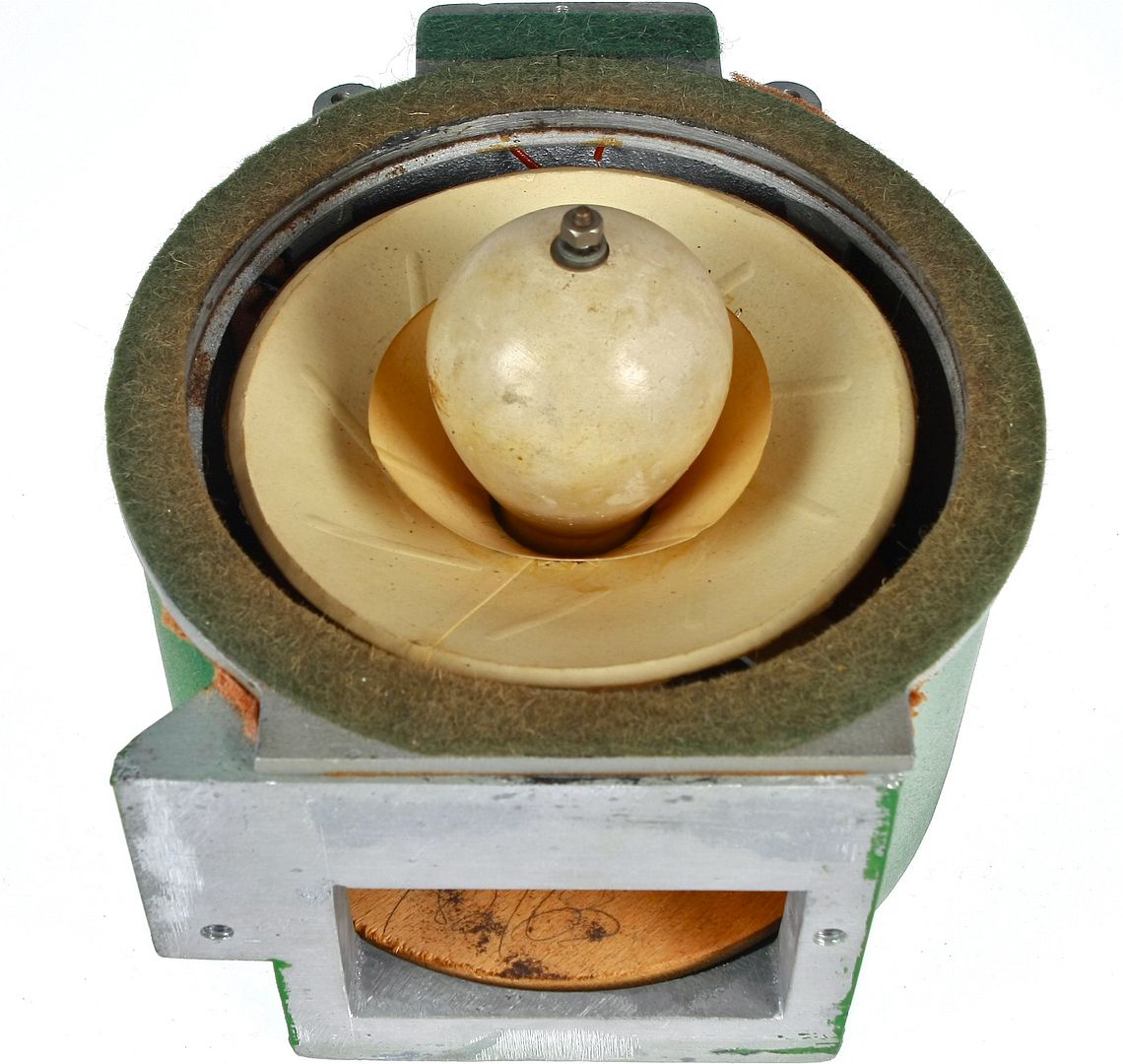

That's a very unusual phase plug. So did you make a "cut" to free the horn from the mold? It looks like it would be challenging given the twisty one-piece nature of the horn.
I'd love to hear more about how you fabricated the mold.

The only part of the mold I have kept is the compression chamber – first picture. I have described the mold here:

On phase plugs, I don't like the modern phase plugs. I have cast from an original 1950s PM3 phaseplug which looks like a lightbulb. Rather than being a waveguide down the profile of the whizzer cone, it forms an expanding space as a horn. This takes away the agressiveness of a straight whizzer cone, loading and damping it well, and the roll back on the whizzer is then unnecessary. The rollback to my ears and direct comparison causes a confusion of sound, a lack of clarity, and guests who come to see me and hear Lowthers likewise prefer the straight whizzer.
http://i49.photobucket.com/albums/f298/furylovelolly/AG%20Ebay%20Shop/IMG_8401.jpg shows this clearly
(NOTE: this photograph may not be displaying proportions properly - click on the link to see the original)
