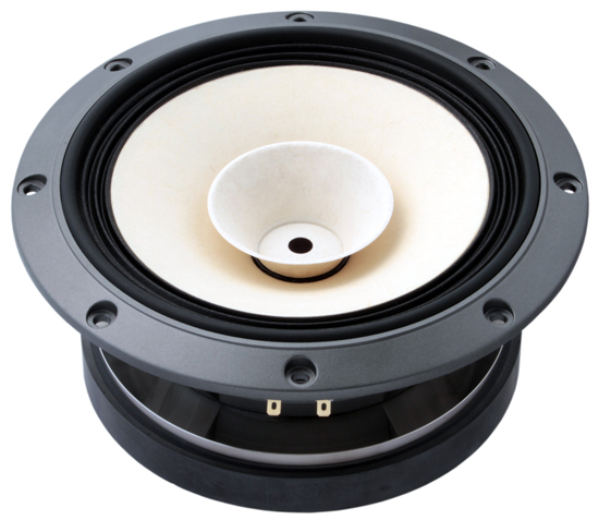

You are talking about the FE203eSR Limited Edition?
Click the image to open in full size.
If you want to add a tweeter passively, you need to get one that is more efficeit.
The only way you can make an 87 dB tweeter work is to biamp.
The budget option Fostex FT96H Horn Super Tweeter: Madisound Speaker Store
