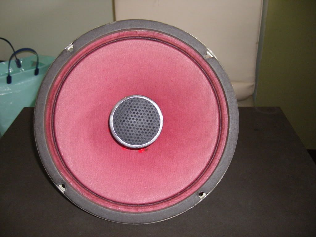

I've found the Braveheart of DIY driver modification.
Tannoy III LZ,
Click the image to open in full size.
Yes, the dust cap has been removed and now the driver looks like this:
Beer or beer cans makes everything sound better.
Tannoy III LZ,
EDIT: lug slug woofer rattle...........serious surgery
