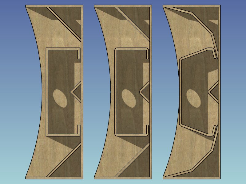

So I had been thinking of building a nice SB Acoustics MTM pair as my next project, but I really wanted to do something different than my previous projects (running TM pair with a gigantic ported sub, tri-amped & filtered with DCX2496). A friend has been building Fostex BLH's and some crazy 10' long loaded horns for a few years and I always liked the aesthetics and efficiency.
Obviously the Changs are not horns really, but they look really cool and apparently have great performance. It seems that the driver of choice, the Fostex FE207E, does well, but it looks like it really sort of dies above 10kHz (which is pretty respectable for an 8" driver). I would LIKE to avoid adding a tweeter if possible since I find simplicity to be elegant. The FE206E seemed to go all the way to 20kHz but it is unavailable and might not be suited to the CC. There is also the F200A that seems to get all the way up, but the price is a tad heinous at $480 each!

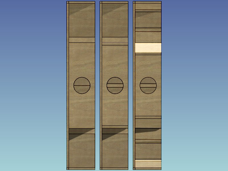

So anyway, I will likely end up running an FE207E with a tweeter crossed over with a capacitor somewhere in the 8-12kHz range (any recommendations on the setup?). If people have better suggestions I am all ears. What sort of cone excursion do you get in the CCs? Is it tightly controlled like a horn, or is typical bass-reflex behavior the case here? These don't get the boost in sensitivity that horns do, either?
Since I haven't had any involvement in the design of these speakers, I probably should not be mucking around with changes to them. But, I enjoy the fabrication process and the challenges posed in it, and it is always nice to add custom touches when possible. See the renders below for some a rough idea of what I was thinking. The middle model really has not been changed much...just some simple round-overs.
I am more interested in the possible effects of the model to the right with the tapered bass enclosure & approximated circular arc for the mouth deflectors. Were things like this ever experimented with? Reducing sharp angles wherever possible can help with reflection formation & such, right? Of course, I may be putting too many assumptions in here that I really don't have the capability to simulate; I am guessing that I will be told to stick with the original design (which wouldn't come as a surprise).

So anyway, I will likely end up running an FE207E with a tweeter crossed over with a capacitor somewhere in the 8-12kHz range (any recommendations on the setup?)... What sort of cone excursion do you get in the CCs? Is it tightly controlled like a horn, or is typical bass-reflex behavior the case here? These don't get the boost in sensitivity that horns do, either?
Most people use FE207 with a tweeter. FT17 is the budget choice. FT96 if you have deeper pockets. They can be XOed at 12-15k with a cap + L-Pad, or you can try my preferred method of using the XO roll-off to attenuate the tweeter. XO high enuff that the tweeter level has fallen off enuff to meet the 207 at the right place.
Middle is OK. Right is going backwards toward Bruce. Unlikey to work as well as either.
dave
If the FE207 + a tweeter is the preferred method then I will probably go that route. Can you point me toward a good thread with the preferred l-pad & XO design?
I figured that I probably wouldn't be able to improve on it with an uneducated shot-in-the-dark. I'll just stick with the design that the people who know what they are doing came up with. Any chance a middle-right hybrid would be decent? (keep the square bass enclosure, but use the pseudo-round deflectors)

Blog Entries: 4
FY17 + 207 is covered pretty well, IIRC, in the curvy Chang thread.
The middle variation is OK, the waveforms affected will not see any of the differences.
At the frequencies involved there are no reflections just an expanding volume. Changing the rate of change of that volume screws things up.

Well, it looks like I will go with a nice, stock CC, as the designers intended. Veneering round features is not something I really wanted to mess with anyway.
Quote:
dave
I sort of figured that this would be the case. I suppose that the design's apparent simplicity masks the fact that there is deliberacy behind every dimension. (I should trademark that, it's pure marketing gold!)
