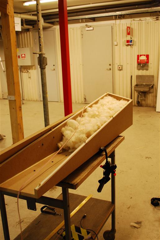

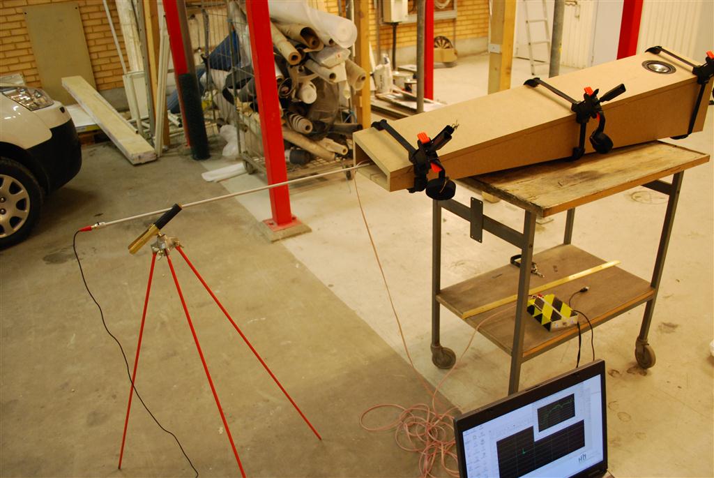

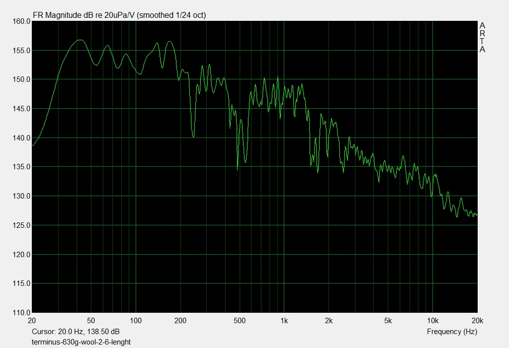

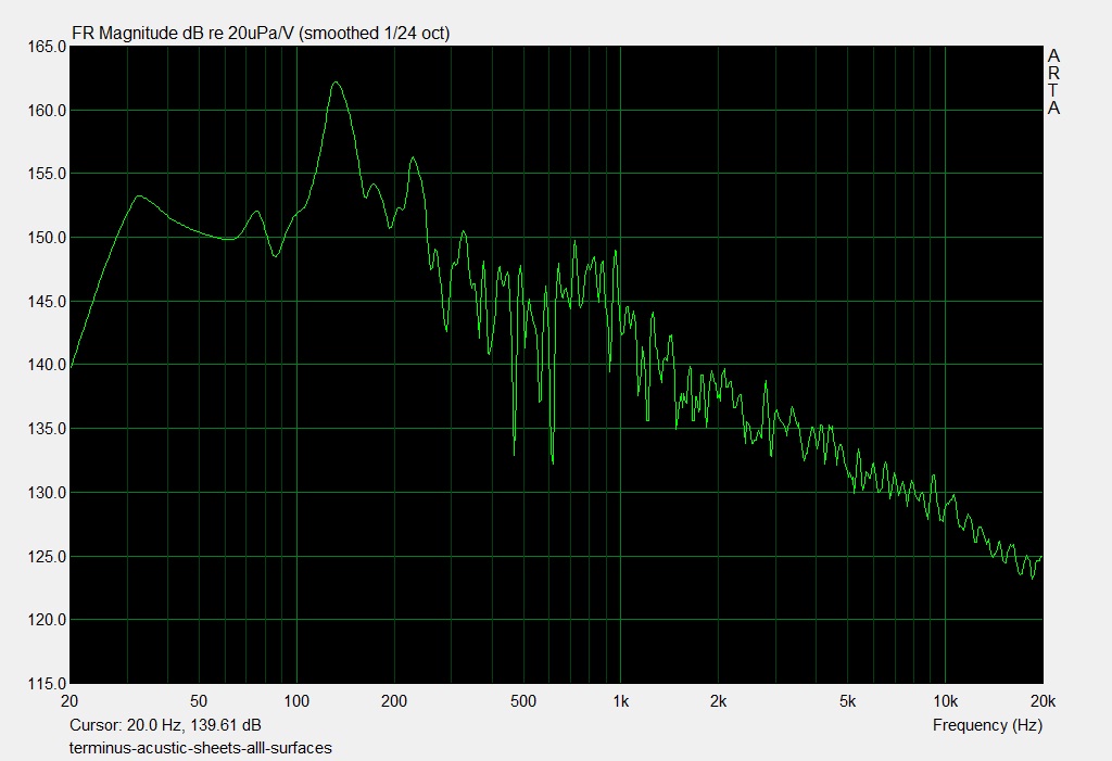

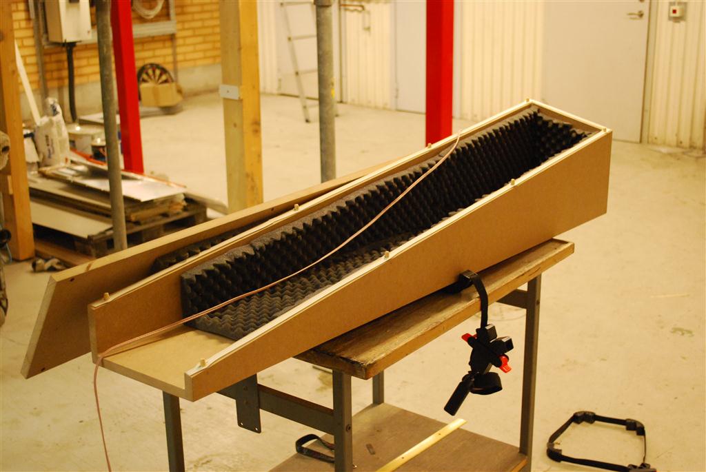

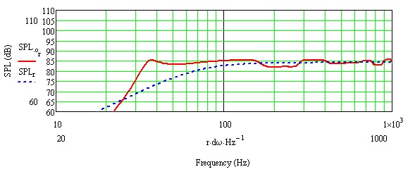

I have built one of the cabinets and measured the terminus with different damping.
Driver CHR-70
Line lenght 145 cm
Taper 5:1
Simulated
Click the image to open in full size.
Setup
Damped with foam sheets.

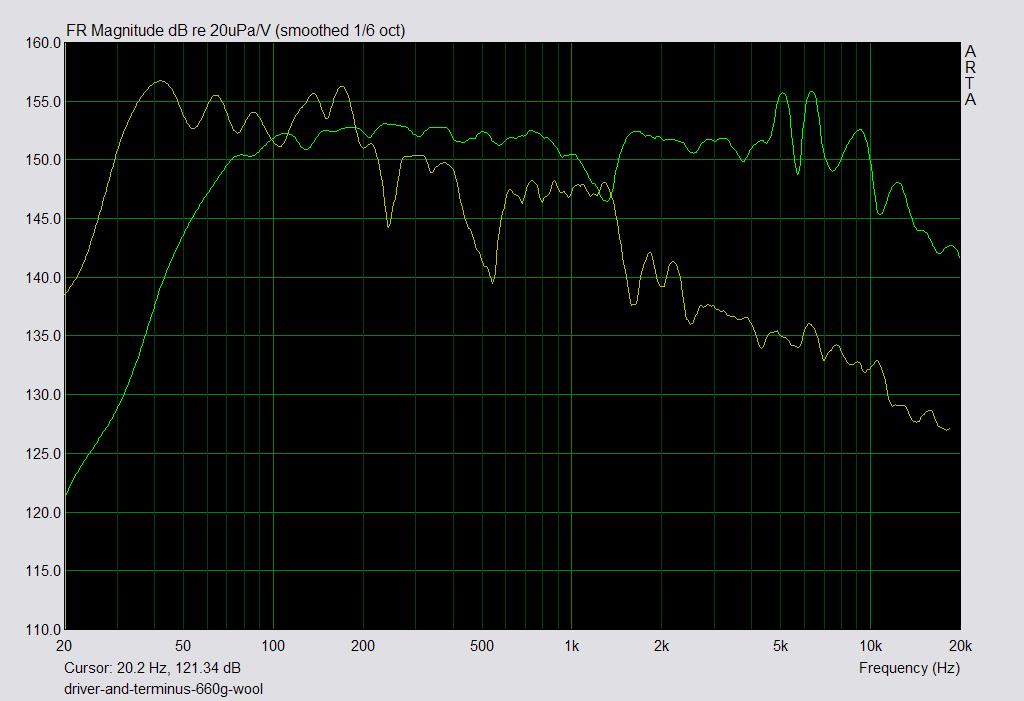

Resulting FR graph
Damped with sheep wool (660g)
Resulting FR graph
Driver and therminus in same graph
Regards H@kan

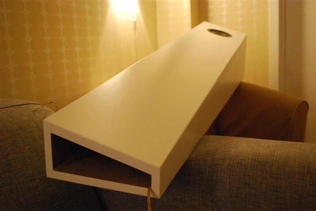

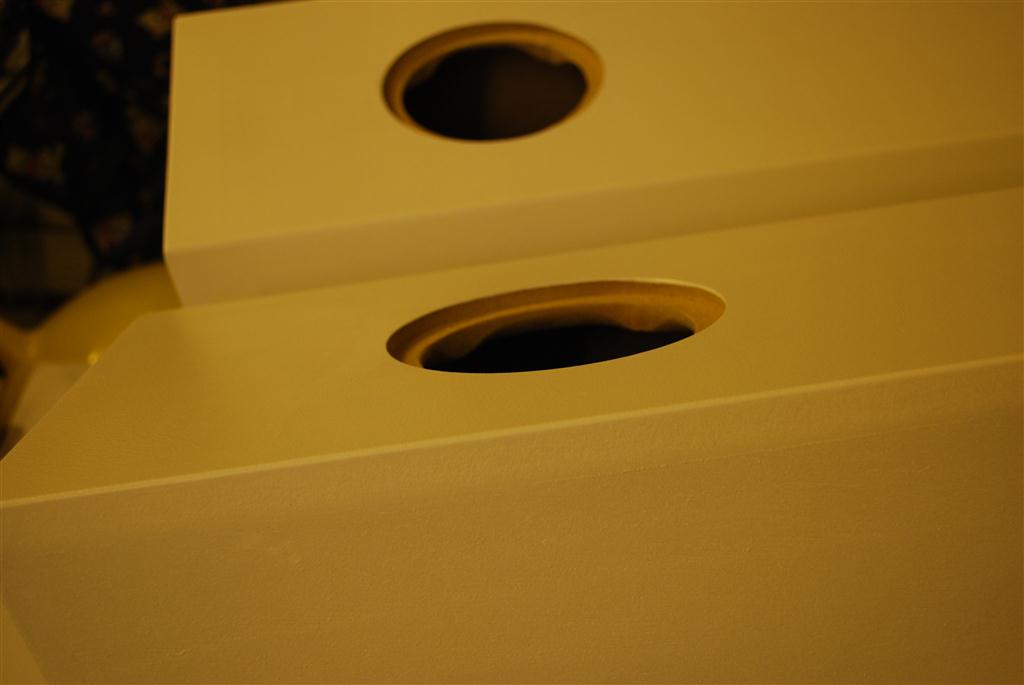

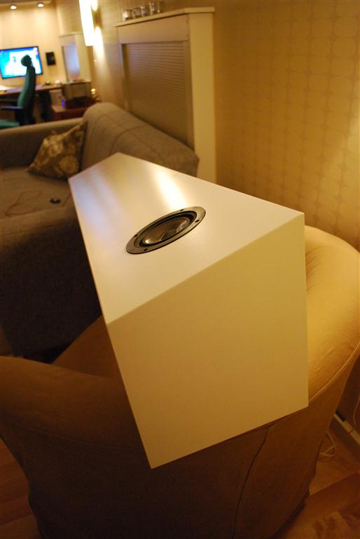

Finishing up. Can't wait to listen to them in the ceiling position.
Regards H@kan
