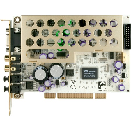

lohk said:
What about the Audiotrak Prodigy 7.1 HiFi ?
VIA Envy24HT (ICE 1724) Audiocontroller
Wolfson WM8776 / 8766 Audio-Codecs
2-, 4-. 6- (5.1), and 8- (7.1) channel 24bit/192kHz Audioplayback
optical in / out
output opamps in sockets - can be upgraded
http://www.alternate.at/pix/prodpic/450x450/k/kk-v30.jpg
http://www.alternate.at/pix/prodpic/450x450/k/kk-v30_1.jpg
Looks good, and price is great, i was checking Auzentech X-Meridian 7.1 DTS Connect but price is like double than Prodigy.
