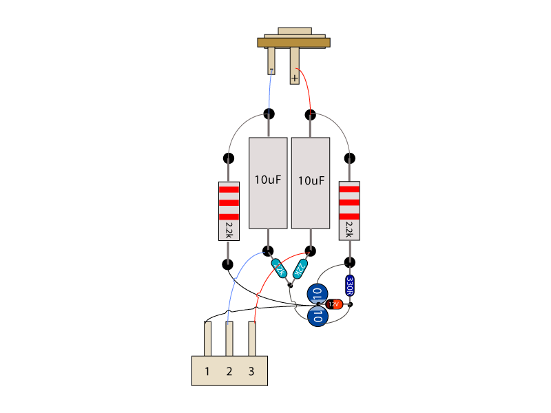

First, I'm totally new to this electronics thing, but I really enjoy it, and I am really looking forward to learning a lot more about it.
Ok, I'm trying to build a headset microphone that is powered by phantom power, and I found this schematic online:
Click the image to open in full size.
So I thought that would work so I decided to build it, then I realized I needed to plan it ahead before building it. So I made this drawing, and I am just wondering if this is correct?
The top TS jack will connect to the capsule, and the bottom XLR will connect to the mixer.

Yes, that's right... for a small electret type mic capsule (e.g. panasonic WM62 6mm dia).
P.S. the choice of input series capacitor is important here.

Sorry to revive this old thread. But I have a question. I left this project before completing it because I had to go to the hospital, then I forgot about it for a while, then I found the drawing while cleaning up my computer.
So I thought I'd pickup where I left off.
In the schematic there is 10uF non-polar caps, these have been quite difficult to source. The only ones I found were huge. These are coupling capacitors right? Is there a way I can could alter this to use polarized electrolytic caps? Without danger to the circuit?
Thank you,

Those capacitors can be 10 uF "standard" polarized electrolytics, with the + sides going to the more positive voltages, which are the "HOT" and "COLD" terminals. Voltage rating of these should be 50V, so the phantom power 48V doesn't exceed their ratings.
