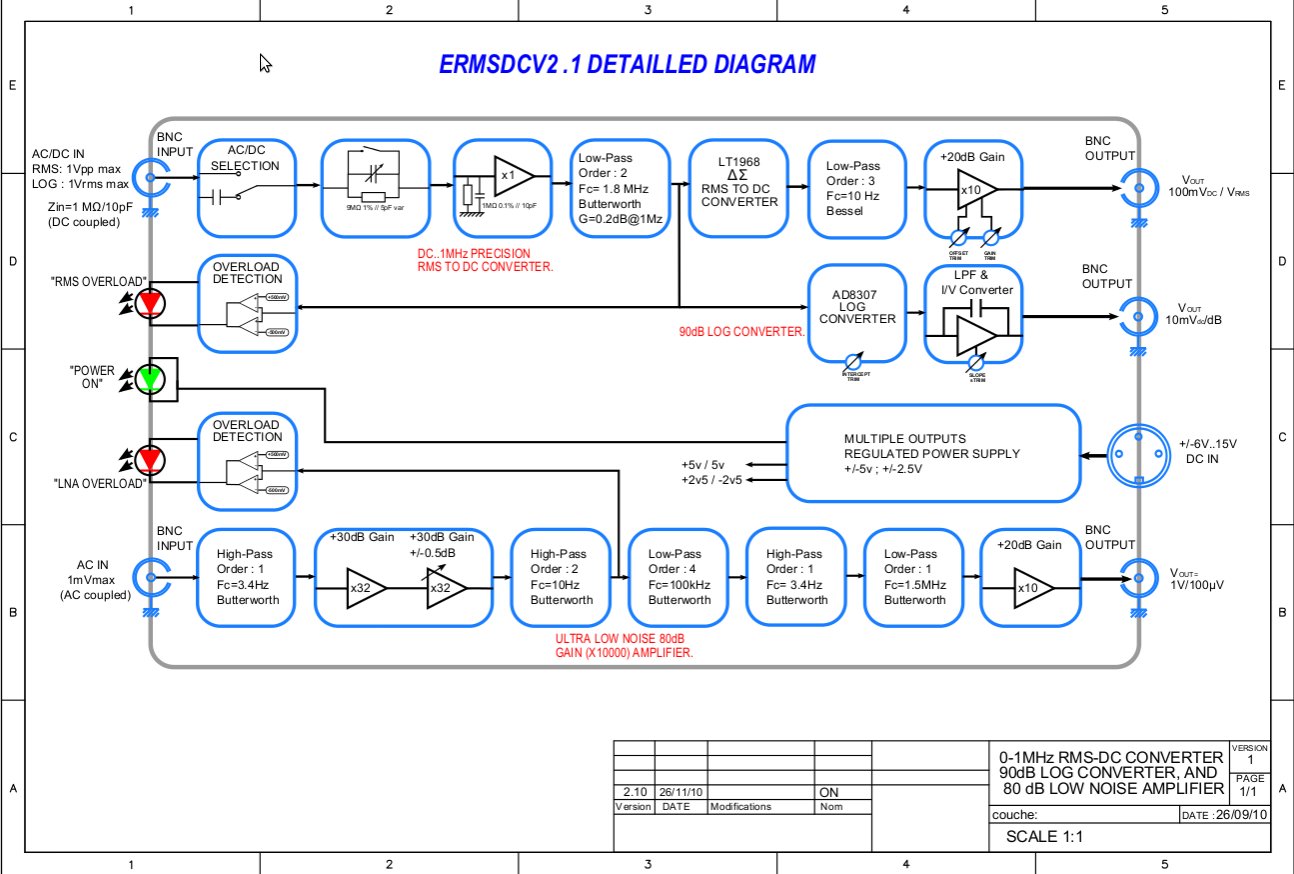

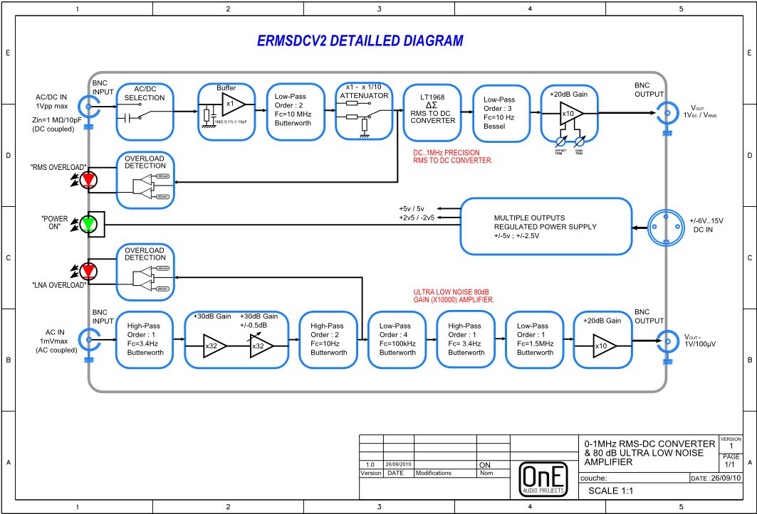

You can see below the functionnal synoptic of the new projects ERMSDCV2 with above features :
[Pict2]

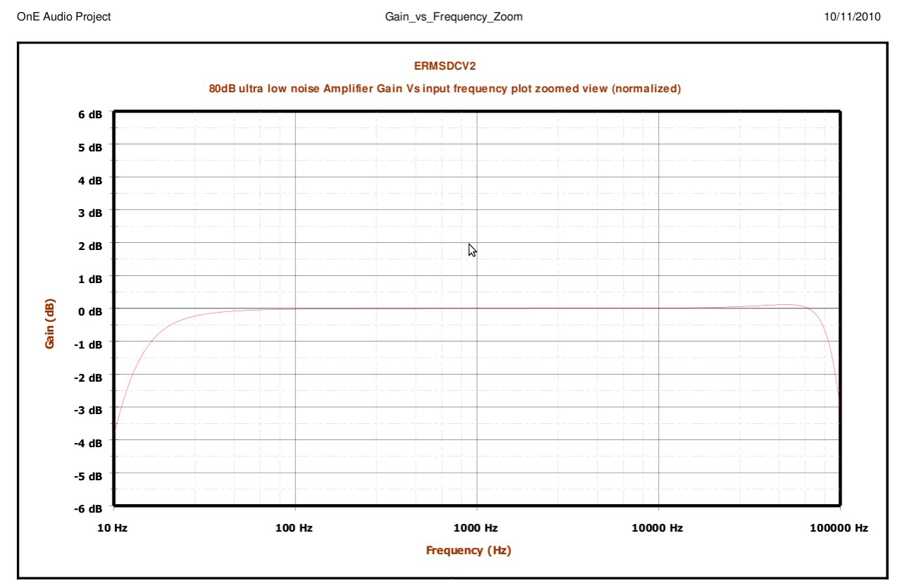

The LNA doesn't change in the V2, just an overload detection is added, and the possibility to use SMD or DIP parts(dual-pattern).
You can see below the resulting frequency response of the LNA, and it's own output spectrum with shorted input.
(It's not simulation results, but real measurements !)

The new schematic of the ERMSDCv2 is done, you can download it HERE (pdf file).

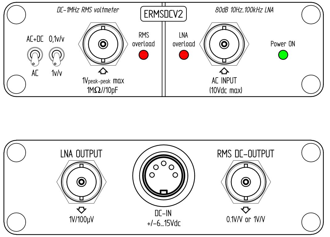

The final design in it's hammong box will look like this ;
[Pict5]
Click the image to open in full size.

I post some measurements done this week with the new ERMSDCv2.
First, the output noise of the 80dB LNA.
This measurement was done with 50 Ohms termination at input.
You can see that the output noise is about 5mVrms, corresponding to
500nV at the input.
Now, it is the transient response of the LNA.
The input signal come from a square wave generator, with a 1Mohms/1ohms resistors divider to get the right level (the full scale of the LNA is below mV !).
You can see below the frequency response of the LNA (normalized: 0dB=+80dB)). Amplitude and phase are plotted.
