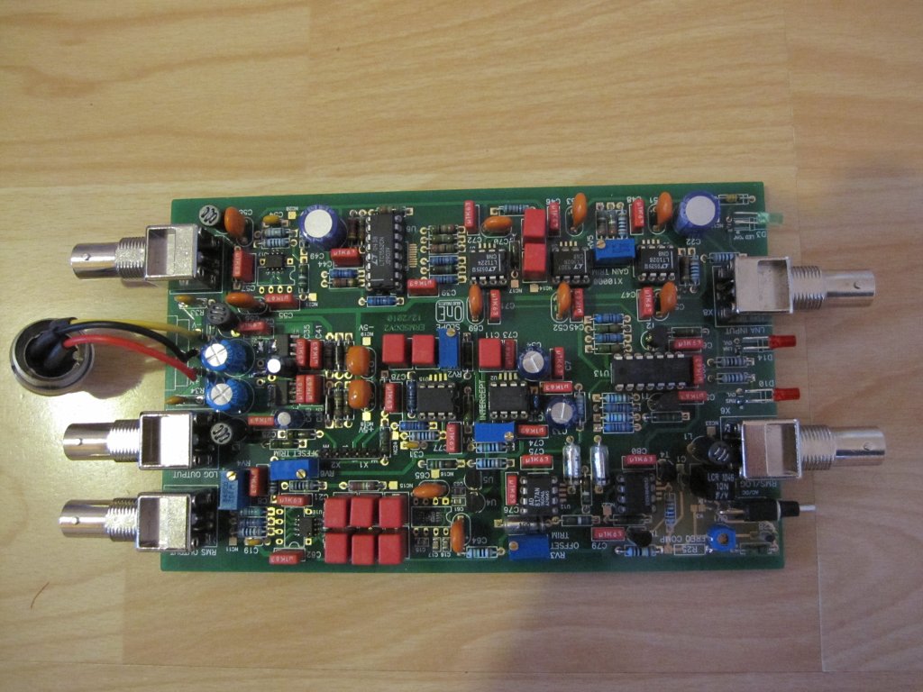

Hello all,
My PCB is now fully wired.
I hope the test within the week.
I will post all results when these will be done.
I will also add some notes about wiring, because many wiring options are available. I prepare a new version of the design folder.
Click the image to open in full size.
FRex

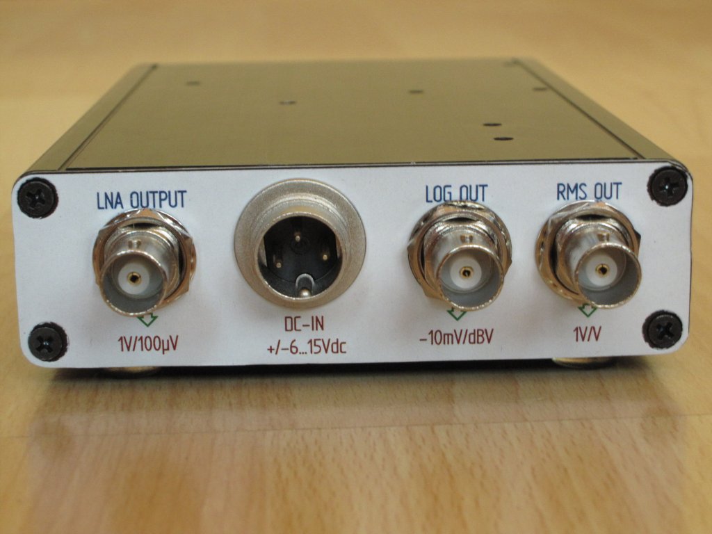

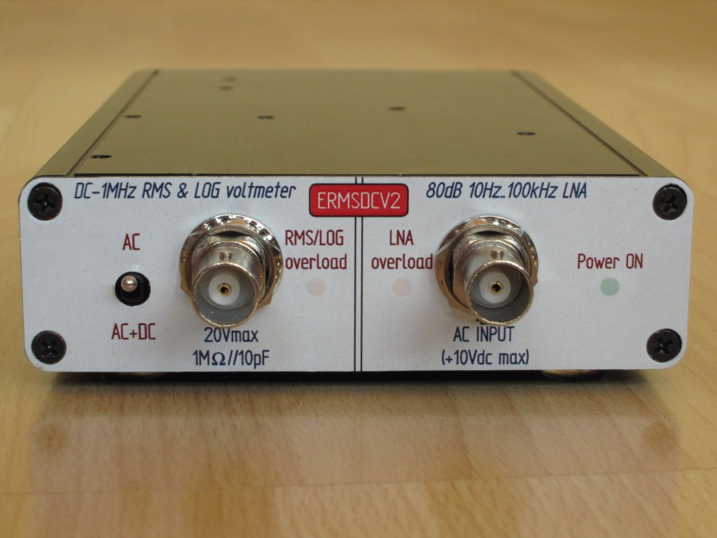

Hello,
The Hammond enclosure is fully drilled and the board fit very well.
I have also designed a laser printable sticker as a silkscreen for front and rear panel. It's easy to do and result is pretty good.
I will add it in the next design folder of this project that i prepare.
You can see the result on pictures below.
Next step now, is to test it !
I'll do that this saturday. To soon.
Frex.

Post ERMSDCV2-- All measurments results.
Hello,
After soldering all parts, do the functional tests and drill it's enclosure,
i have run many measurements on my ERMSDCV2 to qualify it's practical specs.
Test concern the three functions of the ERMSDCV2 design :
_The DC..1MHz RMS to DC converter
_The LOG AC voltmeter.
_The 80dB 10Hz..100kHz LNA
As you will see below, results are very good. The instruments could be really
useful for audio/electronics investigations.
I have write a test and trimming procedure allowing very simple adjustment
to get a fully functional and calibrated device. I will send new documents to all PCB buyers.
Note that i had need to do some little modifications on the design to correct mistakes.
(Please read the wiki main page about that). This will be also included in new files.
You can download the latest schematic version (including all modifications)
here : ERMSDCV2.3_sch.pdf .
Otherwise specified, all tests are made using 1X probe (a coaxial cable) with the
jumper W3 closed, and front panel switch in DC position (down).
The device is powered by a +/-9VDC linear PSU.(+/-6v to +/-15v maxi)
