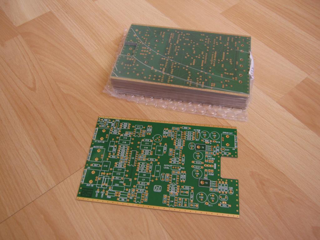

Oscillators pcb arrived!
Hello,
Some news for the group buy of oscillator PCB.
I have receive today PCBs by Fedex.
Again a very good job of pcbcart.
Unfortunatly, i had need to pay little customs fees..:sad:
Fortunately, it's only 15.96€ to be divised by the number of board
giving 1.3€ for each board ~1.63$ (today 😀).
I'm sorry for that..
(Despite many worldwide buy, i really don't know yet how French customs work !....)
Each buyers will receive very soon (this week-end) a e-mail with
a zip file wich include all needed files to build the oscillator.
I'll send also a copy of the Fedex invoice for customs.
I hope to ship all circuit-board in the next week, as soon as you
will paid this little extra cost.
For finished this post, a little picture 😉
Frex.
