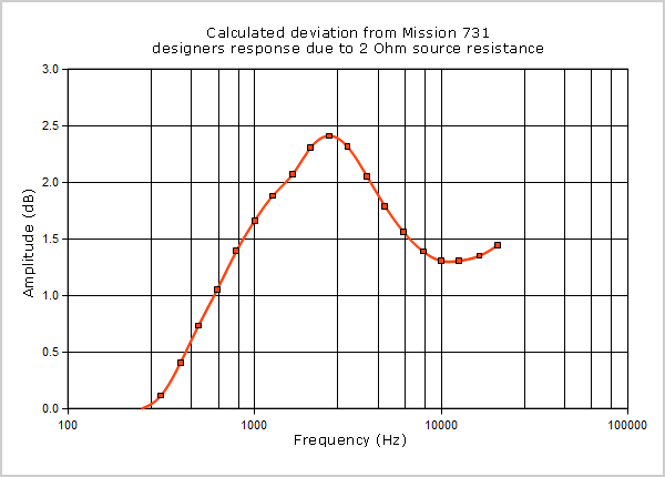

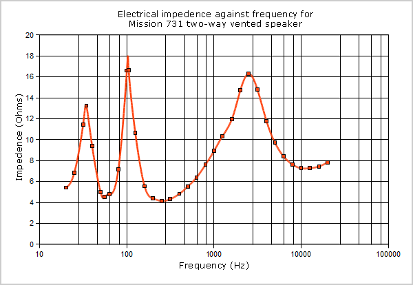

Unfortunately, practical loudspeakers have an impedance ZL that varies with frequency. See Fig. 03.ZL = impedance of loudspeaker
rs = amplifier source resistance
Figure 3: Impedance curve of typical modern loudspeaker.
Despite being specified as an 8Ω loudspeaker, this measurement of the Mission Electronics 731 shows it to be a 4Ω woofer allied to an 8Ω tweeter. This is common practice because:
- It allows a 3dB improvement in apparent sensitivity (dB/W), so the loudspeaker sounds louder, and loudness sells. The 4Ω woofer actually consumes twice as much power as advertised, but a modern transistor amplifier is a voltage source and perfectly capable of driving a 4Ω load at low to medium frequencies.
- Tweeters are typically 3dB more sensitive than woofers. This imbalance could be equalised by adding a series resistor, but a more elegant method is simply to redesign the tweeter for double the impedance and benefit from reduced amplifier distortion at high frequencies due to increased load impedance.
Unfortunately, as will be demonstrated, a single-ended triode amplifier would be most unsuitable for this class of loudspeaker. In order to minimize amplifier distortion, the single-ended triode amplifier would have to treat the loudspeaker as a 4Ω load, so it could have anything up to a 2Ω source resistance, modifying the electrical response at the loudspeaker terminals and thereby deviating from the loudspeaker designer’s response. See Fig. 04.
Figure 4: Frequency response error caused by 2Ω source resistance.
Note that the effect of the non-zero source resistance is to produce a 2.4dB peak at the ear’s most sensitive frequency (2-3kHz) followed by a +1.3dB shelf to 20kHz. The effect on the bass response has not been shown because it does not follow directly from the electrical response at the loudspeaker terminals, but a bass peak can be expected. Summarizing, any loudspeaker designed to be driven from zero source resistance will exhibit deviations from the designer’s response if driven from a non-zero source resistance.
Below 2.5kHz, the rise in impedance is caused by woofer voice coil inductance, and above 2.5kHz, the fall in impedance is caused by the crossover beginning to connect directly to the tweeter. The two effects combine to produce a peak at 2.5kHz, so a peak of this form is always indicative of a crossover. It is possible to engineer a crossover having constant input impedance, but it is expensive, so the idea has not become popular.

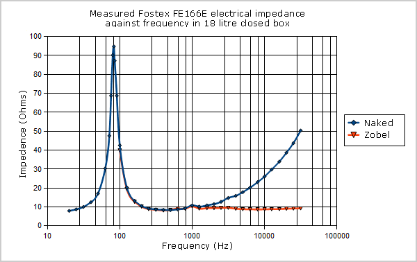

The Zobel network
Above low frequencies (> 250Hz) the electrical impedance of any moving coil cone loudspeaker may be represented by the series combination of its voice coil DC resistance and inductance. If we add the complex conjugate of this impedance in parallel (known as a Zobel network), we can correct it to a constant resistance. See Fig. 05.
In theory, the Zobel resistance RZ is equal to the loudspeaker’s RE, and the capacitor value is found using:
In practice, transformer coupling from the voice coil to the shorted turn of the steel pole pieces either side of the gap means that RZ is typically empirically multiplied by a factor of 1.2. Alternatively, values for RZ and CZ can both be found experimentally using a starting point of RZ = 1.2RE plus a decade capacitance box together with a variable frequency oscillator and meter as shown. See Fig. 06.
The output resistance of the oscillator and the Zobelled loudspeaker form a potential divider whose output is measured by the meter. A good source resistance is 100Ω, but this value is not critical. Ideal Zobel values produce minimal change in the meter reading as oscillator frequency is swept. Note that most DVMs are only designed to measure 60Hz AC and have large errors above this frequency, so a dedicated audio meter is usually best.
Using the previous setup, suitable values for an FE166E were; RZ = 10Ω and CZ = 5.16μF (4.7μF in parallel with 0.47μF is quite close enough). The author used a hot-melt glue gun to glue the capacitors directly to the loudspeaker’s magnet, then soldered a non-inductive 5W thick film resistor to the capacitors and hard-wired this combination to the loudspeaker terminals. See Fig. 07.
Adding this Zobel network produced the electrical effects shown in the graph. See Fig. 08.
Figure 8: Comparison of loudspeaker impedance with and without Zobel network.
As can be seen, the corrected driver has a very nearly constant resistance of ≈ 9 Ω above 200Hz. The slight blip at 1kHz is not a measurement error but is thought to be a dust cap/voice coil mechanical resonance being coupled back into the electrical impedance. The impedance peak at 83Hz is electrical confirmation of the system’s mechanical resonance and is a good indicator for any system of the lowest frequency that can be reproduced without equalisation.

Fit the Zobel network to the driver. Take wires from your terminals to the driver. The driver now needs to be laid on the front baffle and will leave a dent in the felt unless you put a thick piece of cardboard in the way. Tease out ≈ 120g per box of long-haired sheep’s wool (as used in transmission lines) or BAF wadding and completely fill each box. Secure the driver to the box with self-tapping screws, taking care not to let the screwdriver skid and puncture the cone. Pozidriv (Europe) or Philips (America) screws are a good idea. Tighten opposing screws sequentially to avoid distorting the basket.

Concerning the Zobel this is a nice touch to maintain the match to a 6.5ohm source.

First, a "Thank you" to Martin Colloms for his observations. As he's the author of "High Performance Loudspeakers" (now into its 6th edition, and thoroughly recommended), we can assume he knows of what he speaks. His comment about baffle step and 3dB is spot-on, since I only needed 2.4dB in my living room. As for positioning braces, I'm ready to believe that there could be better or worse positions, but the central position seems to work and gives the baffle around the drive unit support. I agree that capacitors can be microphonic, but my reasoning for glueing the capacitors to the magnet was that it has a lot of mass and is rigid - which is probably more than can be said for anywhere else in the box! Still, it's an easy enough change to experiment with.
I think the stuffing observation is valuable and well worthy of experimentation. The one thing we do not want is to shake the mass of stuffing up and down. I would expect changes here to affect the bass and low midrange.
I did initially do some calculations on the palliative effect of the flatter loadline allowing greater voltage swing into the loudspeaker plus series resistor, and therefore restoring some of the power you'd expect to lose, but the effect wasn't as great as I'd hoped and the article was already getting quite long, so I left it out.
RFI is insidious - especially if you consider loudspeaker cables to be aerials connected to an amplifier's input stage via a global feedback loop. I seem to remember A N Thiele writing an AES article about this effect and suggesting RF filters at the output of the amplifier. The RF Zobel idea seems to be more aimed towards preventing the loudspeaker cable acting as an incorrectly terminated (and therefore resonant) transmission line.
