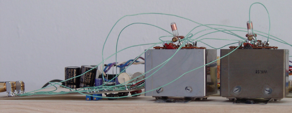

I'm infected by the nosser virus.
One of my current projects is CS8412 --> PCM56 with MSB adjust --> passive I/V resistor 500 ohm --> step up transformer --> 1,34 nF shunt filter cap on secondary --> out.
The sound is very good, no grain compared to os.
Perhaps a little warm, but not as much like TDA1541A.
OdB test signal has K2 -70dB. I think that comes from passive I/V.
-60dB test signal has noise floor -60dB and no harmonics.
Should I try a firewall filter ?
Click the image to open in full size.
