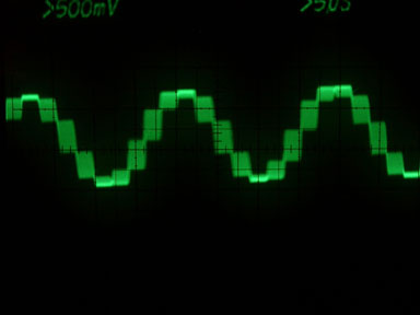

Is it true ? Looks like that on my scope.
So resolution at 20kHz is only one bit out of 16bits for each halfwave ?
Click the image to open in full size.
4xOS gives 4 samples but only interpolated.

That's correct.
Even though it looks hideous, theoretically* your 20KHz sine wave is perfectly represented at a 44.1KHz sampling rate.
*neglecting 16-bit quantization noise, zero-order-hold attenuation, system noise/distortion, assuming a perfect reconstruction filter to eliminate images, etc.

You still have 16 bit resolution, but only 1 sample (with 16 bit resolution) for every half wave.

Indeed, in fact you should look at it as 2 samples each 16 bit for a 20kHz wave. The reconstruction filter, which is an integral part of the D-A conversion process, will make sure you get a nice sine wave. That is the background behind the Nuiquist criterium: to reconstruct a given freq you need at least 2 samples to nail down the level and phase, so you can convert frequencies up to half the sample rate.

Well, 44.1 or 192kHz gives the same reconstitued sine at 20kHz from 2 samples or 6 samples or what have you. The difference lies in the noise spectrum. The higher you sample, the higher the noise turns up in freq, so the easier it is to filter out. At 44.1 kHz you would need a brick wall filter at 22kHz to get rid of all the noise, and brick wall filters don't exist in analog. They do now, of course, in DSP implementations. So, there are different issues, that are related, but not interchangeable.
But, how counterintuitive it feels, 2 samples will nail ANY wave, provided you take care of the postfiltering.

That is why the post-DAC filtering is AN INTEGRAL PART of the conversion process. It only works as advertised if you include the filtering.
