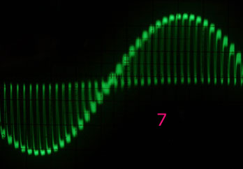

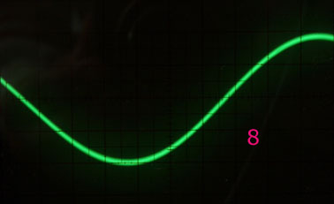

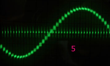

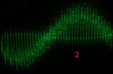

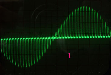

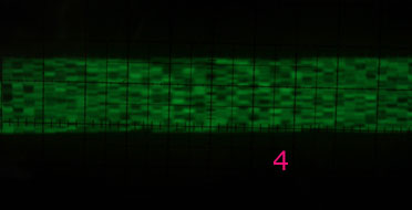

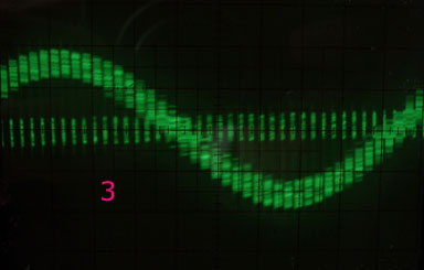

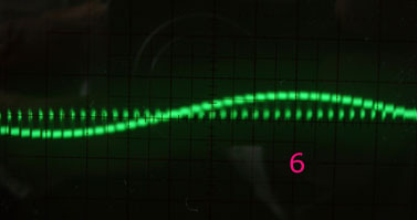

again, what happens here in my 1 x PCM53 for both channels TEAC ZD700 ?
Still I do not understand the circuit except that left and right must be separated.
Is this non-os ?
In pic 1 the sine consists of 44 spikes, and
in pic 3 there are 44 stripes on the bargraph inside a 1kHz sine = 44 kHz ?
Sine is 0 dB.
The bargraph remains when player is on pause.
Is the bargraph some kind of help-signal ?
Schematic + scope pics:
Click the image to open in full size.

that seems like decimation.
here's a link that explain it:
http://www.tnt-audio.com/clinica/convertusdecima_e.html
  Reply With Quote
Old 8th May 2005, 08:06 PM   #3
diyAudio Member
Bernhard's Avatar
Join Date: Apr 2002
Location: Munich
Thanks,
looks really like decimation and maybe they applied also dither,
the bargraph is noisy and when I look at the schematic now spontanously I see the following possibility:
the switch close to 6 removes the audio samples from the signal, leaving the noise and the inverted noise is added to the original signal so that the noise cancels at the resistor bridge at 7.
I made mistake reading the values it is 15k, not 150k. Very small resistors...
Now is that decimation done in the analog or digital domain ?
The low level performance of that DAC is the best of all multibits I have seen and I want to built it with two DAC chips but now it becomes tricky...
Is there a way to use the left deglitch and right deglitch signals to separate the left/right data for two DAC chips ?
Comments ?

When adjusting the pots there is pink noise that can be adjusted to disappear, so there must be something like dither.
The OS chip is TEAC 52200492-00
  Reply With Quote
