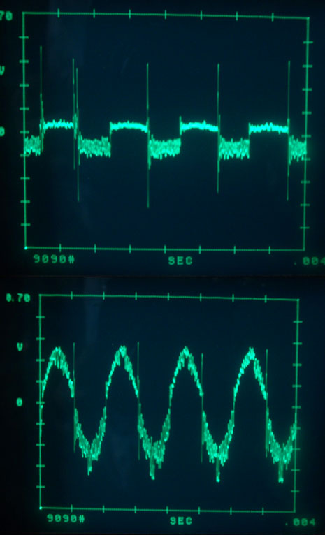

in my PCM53 project with SM5803 & DENON chip for data conversion I have a problem.
The SM5803 datasheet from the web is incomplete, page 130 is missing.
SM5803 unfortunately has a seriel input register with 13 flags to set output data word length etc.
Now I have no idea how to input the data to set those flags, this information is on the missing page.
Any other OS filter I can use ?
I need
20 bit output
output COB
left and right data parallel out
4 x OS
Or can I go directly zero OS from CS8412 to the DENON chips ?

The DENON chip only accepts 20 bit, otherwise there is noise only.
It works with the SM5813 but it is 8 x OS and in the datasheet the PCM53 is only specified to work on 4 x OS.
Also again I have the positive and negative spikes ( very close to each other ) on every zero crossing of the 1kHz signal..
No deglitching or filtering yet, just measured on the output pin of the PCM53.
  Reply With Quote

There must be a big bug.
Pictures show -60dB and -80dB 1 kHz signal.
-80 dB already looks like a square
Wrong data format ?
I had exactly the same problem or even worse when fitting the PCM53 in a JVC player whitch originally has PCM54 DAC.
Edit:
If you look closer, you can see the square from -80dB also in the -60dB signal.
Click the image to open in full size.

According to my data sheet, for 4X parallel mode, you set the OMD flag H. and the 8X output (pin 5) H also. Is that any help?
Jocko
