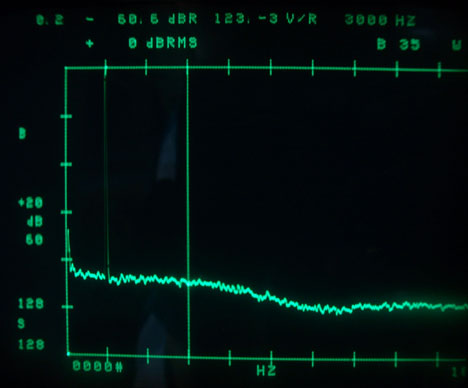

Between 1 kHz and 6 kHz the PCM53 is a little bit noisy in this Teac player with one chip for both channels and I do not know if it is the chip or the implementation ( )
I hope the noise will disappear when 1 chip is used for each channel, and there is nothing hidden under the noise.
It is not that bad, just -60dB instead of -65 dB noisefloor related to the -60dB signal.
Certainly the deglitcher circuit must have some impact on the performance, don't you think?
