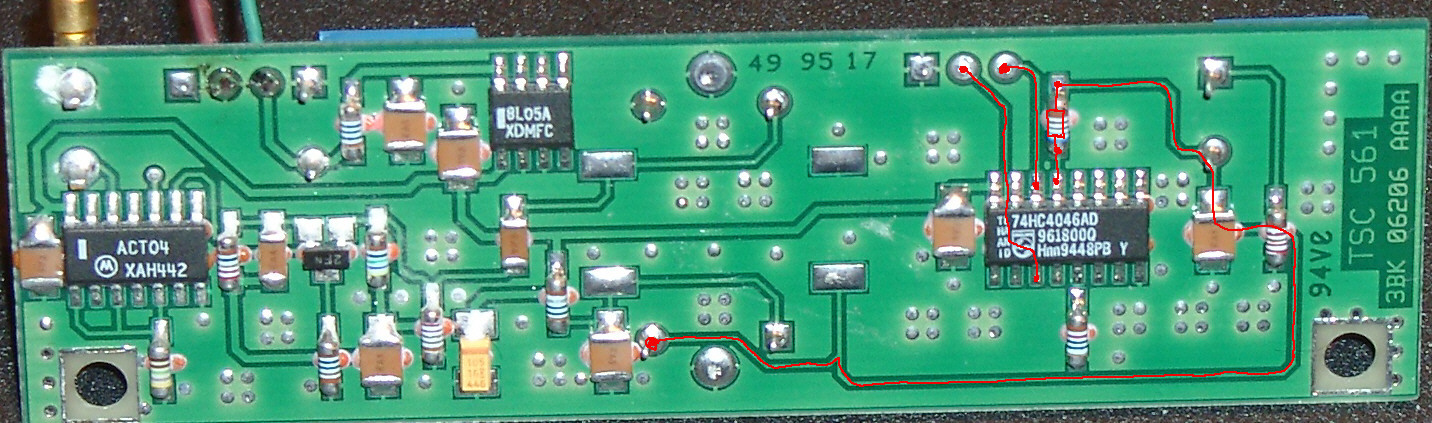

I got this one today, it outputs 13MHz , on the other side is a canned 13.000000 MHz oscillator which is not TTL.
There are two another inputs (?) to the HC4046.
Could this be any good ?
I will open the can and replace the crystal for 11.2896 MHz.

The canned oszillator got a control pin which is connected to the phase comparator output pin 13 of HC4046.
Phase comparator input pins 3 & 14 go off the board.
The VCO of the HC4046 is not used.
What is the sense of this ?

It could be a Quarz-Based PLL. Where do Pin 3 & 14 end ?

Phase comparator input pins 3 & 14 go off the board. To nowhere...
