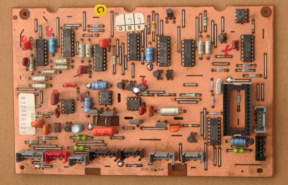

I have a few tested servo boards to fit into CD104, 204, 304, 304mkII, Grundig CD7550, and maybe others.
This fixes 99% of all problems.

How many problematic joints are there on servo board ?
I found two or three , and others are allready factory wired.
Audio board has no such joints , all looks like wired ones , like shortcuts from trace side (two of sloder joints) to ground side.

thats right, there are only two griplet holes in the servoc board plus a number of wire links and axial caps with large solder 'blobs' at the end. The links and caps I resoldered (sucked the old solder and resoldered) the 2 griplets I desoldered untill I could see the end of the griplet. I drilled a hole through the middle of the griplet, desoldered again, then ran a small lenth of tinned wire through the hole and resoldered on either side. NOTE The griplet is still there, I found them too hard to remove without removing the tracks on the non-copper side.
The audio (decoder) has approx 10 griplet connections through plus a couple of the cap/wire link blobs.
