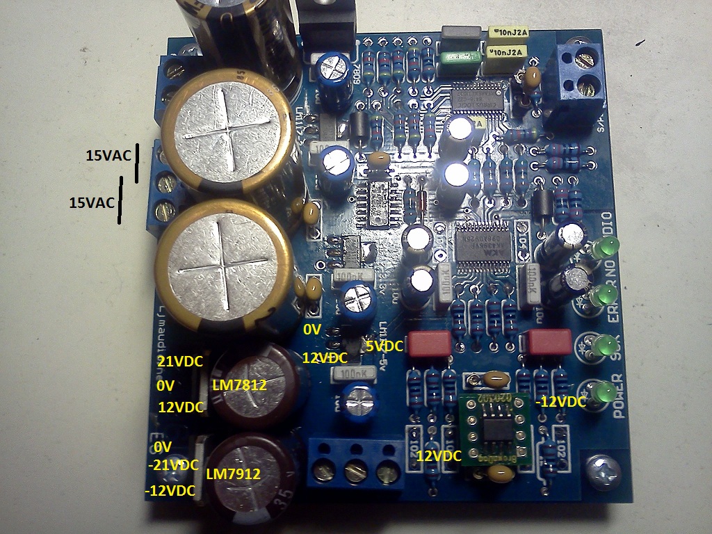

I think the connection should be blue (15) - black and blue (0) - black (15)
Exactly.
According to the label you shoud use (they should be in pairs)
BLU1 -> 15V
BLK1/BLU2 -> 0V
BLK2 -> 15V
Usually the first color in pair is phase and the second is neutral

I hooked together the/a blue black pair with 0 continuity as per apoopoo999's kind advice, but I still have no analogue output.
I'm sad now!
Burst another bubble
Do a get an award for 'DIY Dumbo of the week'?
As I see it there are three logical possiblilities ....
1) I haven't fixed the AC supply issue correctly.
2) I damaged some/several components by applying AC power incorrectly.
3) There was more than one problem/error in the first place, and there is another error(s) still to correct.
I think some of my peers on this forum will know if 2) above is likely?
As always I appreciate any advice you can offer peeps.

Hi Bill,
just to be sure measure (trsanformer only) AC from BLU1 and BLK1/BLU2 (it should measure 15Vac) and from BLK2 and BLK1/BLU2 (it should also measure 15V)
If it's so you wired correctly the transformer.
Probably you burnt one or both the MC7x012.
Try to measure Vdc on them.

Thanks for your help Dario.
I had measured VAC from the transformer before risking applying power to the board (I thought).
I didn't take notes sadly, but I thought I had closer to 15 VAC in my original blue1 - black1/black2 - blue 2 configuration....
Supply voltage here is just a little under 100 VAC/@60Hz.
Here is a low res picture of my notes, red is my actual measured voltages on my DAC.
Bill

It's not indicated but do you have the 3.3 and 5 volt on the other regs?Here is a low res picture of my notes, red is my actual measured voltages on my DAC.
Bill
All seem OK as per attached picture (small print sorry).It's not indicated but do you have the 3.3 and 5 volt on the other regs?
Bill, any of the chip getting very hot?
I'll check that out, I haven't left the thing on too long for fear of smoking a chip.
I can start hunting down the signal trace with a scope...?
Don't really know what I'm doing though...
Thanks everyone.
Bill
Just to point out the picture in my previous post is from Dario with my measured values annotated. It isn't my board.
If you click and then click the full size button bottom left it is readable.

Bill, the values around the 9V regulator seems way too low but it shouldn't be a problem...
Now, apart no analog output, the leds behave correctly?

Bill, did you start with a bare board or modify one that was previously assembled and functioning?

Billo - A shot in the dark - I had a very strange problem when wiring my JC-2 pre (yellow board). If both 0V wires were connected to the PCB the unit would not function. After combining them in a terminal block and running a single wire to the board, everythings works. Makes no sense to me ( I was going to post about it) but believe me, it was the only way I could get the pre to work.
Might be worth a try. In the photo the Lighter Note is also powered by the same toroid, but the problem was there even when that circuit was not involved.
Hi Bob,
It might be that you made a simple mistake. I see the cables (for secondary voltages) are same color. The secondary windings are actually polarized.
Not like positive or negative, but they have a "beginning" and an "end" of the winding. It does not matter how you connect them, as long as the cable to the center point of the pre-amp or DAC have two cables.
One should be "winding 1 END" and the other should be "winding 2 BEGIN". The beginning of a winding is often shown with a dot or a marking.
If you do that wrong, then they compensate themselves, resulting in 0 V (or very close to zero). If that happens, swap two cables from ANY winding.
