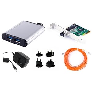

USB High speed Line Isolation using Adnaco Product
ElectrArt's USB DUAL AUDIO board includes no galvanic isolation circuits.
I have tried "SuperSpeed USB 3.0 Over Fiber Optic Expansion System" made by Adnaco, a Canadian company, to evaluate the effect of USB line isolation.
My preliminary impression is the isolation brings a certain level of good effect on the quality of resulting sounds.
The system can provide a galvanic isolation of electrical grounds between external USB Audio devices and PC by achieving a digital data transfer over a pair of optical fibers of computer data communication grade.
Its primary intended use might be for factory automation or medical electronics where a long bus extension or a complete galvanic isolation is required.
The system consists three major parts.
1. Extension card for PCI Express bus in PC
2. Multi-mode optical fiber
3. Two port USB 3.0 interface unit with an external power adapter
As the two USB ports supports USB 3.0, data transfer on USB 2.0 High speed (480Mbps) was achieved without any problem and I could enjoy DSD256 or PCM 192kHz/24bit stereo plays.
This system does not expand any USB 3.0 signals on PC but expands PCI Express bus signals based on their proprietary technology in a hardware domain. Therefore, no special driver software is required for the PCI Express bus card.
Only a driver for TI USB 3.0 compatible USB interface chip built in the interface unit hooked at the end of optical fibers needs to be installed. The driver software is provided by TI.
The expansion system is completely transparent to any audio application level traffics. In other words, any software applications for audio play do not know that a pair of optical fibers are inserted in the connection.
One big limitation is that this system is not applicable to PCs of no PCI Express bus.
An audiophile grade power supply can be connected to the USB 3.0 interface unit. The actual draw is 0.5 A for +5.0 V DC.
The price of the system is almost or slightly over 400 USD including tax and shipping charge. Some people may think it's too expensive while some people may think it's worth paying. In my case, I thought it was a good product to buy.

Hi Bunpei,
thank you for sharing your experience with the USB-isolator! I have been looking for such a device, and I think that this isolator is what I need 🙂
I work in the medical industry (hospital), and 400 USD is cheap. I just bought a USB1 isolator with medical approval, for the pridcut I am developing, and it cost 1200 USD!
Best regards,
S

Hi, staccatiss,
I appreciate your comment very much! It's my pleasure.
By the way, an idea hit me to use this device with a notebook type PC.
Many recent notebook type PCs have an "ExpressCard/34" slot.
Here is an adapter for ExpressCard/34 to PCI Express x1.
PE4L ( PCIe Adapter ver2.1 )
This adapter might be used with the PCI Express card of the Adnaco. But I'm not sure as I have not experimented that.
