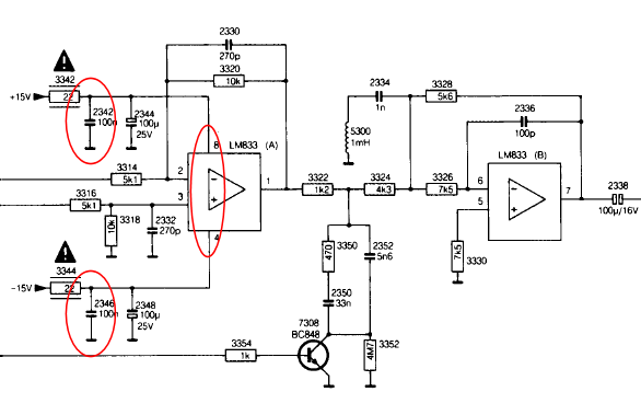

i just started looking deeper at my Philips CD850 MKII.
In the Audio Circiut Schematic i came across transistors 7308/7309/7310.
What's the exact purpose of those circuits ?
In similar designs, like Marantz CD52 MKII, those can't be found.
have a look at the attached schematic.
thanks a lot

They look like they could be part of the De emphasis circuit. They aren't really required on pretty much all recordings.

Ok, will cut-off the De-Emphasis circuits, right ?
Resistors 3322/3324 and 3323/3325 will be swapped out and replaced by a single 5k6 on each channel.

I'd look at the whole output stage! you can remove those muting (7304 & 7306) transistors without too much of an issue and def loose the elco (2338). If there is no DC accross them (2338), link them out. It will be a very big improvement just removing the caps. If there is DC present, look at something like mundorf MKP's or poss better if your budget allows. If you need to buy caps, go for something like 4.7uF Mundorf MKP smaller will kill the bass bigger will sound poor! If you are using a commercial amp, the chances are there will be DC blocking caps on the input stage in anycase!
Also, you may want to try taking point "92" direct as the output (via caps if there is DC) I've often found that the more simple you make the output stage, the better it sounds. You should only need the 2nd stage as a buffer if you are driving long interconnects or a difficult amp! IMHO!!!

i have restarted the CD850-II modding project. Since this player nearly 20 years old, i will first bring all the Caps to "Stage 0". So replacing them with Panasonic FC series, replace the rectifier diodes with Schottky. In the Output Stage i will try some other Opamps. A Tentlabs XO with dedicated Power Supply has already been ordered.
What types of Bypass Capacitors do you recommend in place of C2344/C2348 ?
Philips used Ceramic SMD. Can they be swapped against WIMA MKS2 caps ?
Do you recommend an additional cap betweend the Opamp power supply, Pin4+8 ?
thanks for feedback

Personally, I'd use Rubycon ZA or ZLH 220uF - 470uF (unless you have access to BG) in place of 2344 and 2348. You dont need anything between 8&4 bevuase you are shunting noise to gnd with 2346 and 2342. You dont really want to shunt noise from 1 rail to another!
I would poss use 100nF PPS or COG's for 2346 and 2342. Try with and without the 100n. sometimes it sounds better without!!!
