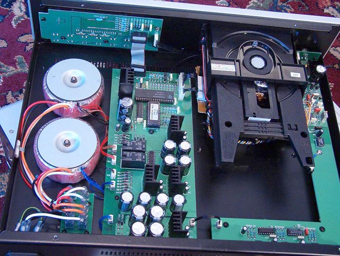

Pic of the Stello
Pic of the Daisy-laser L1210
The loader I'm familiar with, it's the same as in my Micromega, which uses a CDM12.4
If you can identify correctly the pick up then replacing just the pickup is easy.
The pictures on Daisy Laser show what looks like the VAM equivalent for the CDM12.1 which is the pickup and (discrete component) laser power control only. This has the "black" platter which is the magnetic opposite to the light grey one on the CDM12.4 VAM1202
These are listed from spares distributers although I can't say what the original source is... are they genuine Philips etc
