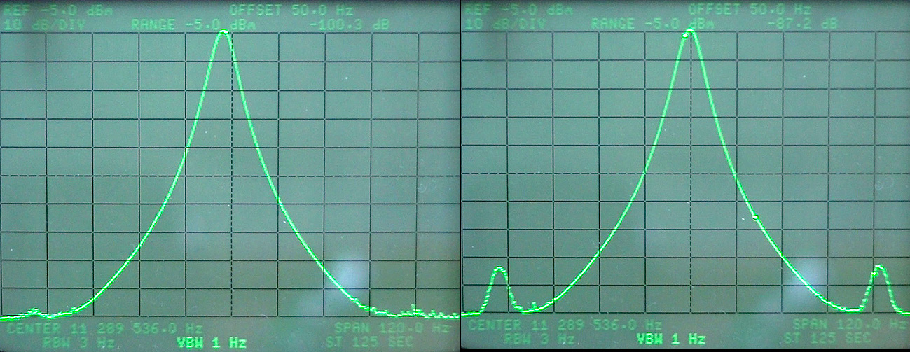

Old 2nd December 2009, 12:40 PM   #22
diyAudio Member
Bernhard's Avatar

About shielding the clock, left with shield, right without:
Without shield would be even worse if there would not be the groundplane of the motherboard shielding the solder side of the oscillator already.
This is 100 dB displayed. The sidebands are 50 Hz noise obviously.
